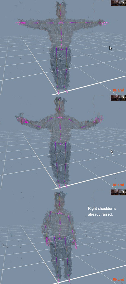

Here's another example of the shoulder issue. This is from a different capture video and all we're seeing here is the performer going from T-Pose to lowering arms. As you can see in this sequence, the right shoulder is already rising up before the arms have completely lowered. From this point, the shoulder tends to stay up in this high position.
I'll track the rest of this motion--I suspect it this error will gradually develop into the bent spine shown at the beginning of this thread. I'll let you how this goes in a bit.

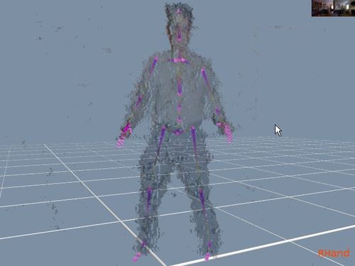

This is from the same motion data about 200 frames into the action. As you can see, the right shoulder is still raised.
The right arm seems harder to track as well, even though it's more or less doing what the left arm is doing.

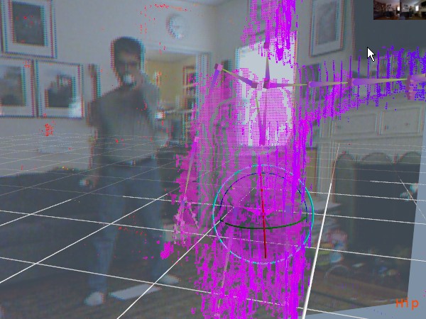

Here's a frame where I had to disable Shoulder Tracking because Studio was pushing the shoulder completely outside the body (the picture shown is without Shoulder Tracking.) Disabling Shoulder Tracking and clicking Refit Pose pushed the shoulder back into the body but as you can see the shoulder is still raised up higher than it should be.
As described earlier, this one case where clicking Refit Pose at first displays a more correct looking shoulder but then settles on this raised pose.

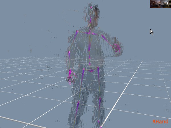

Here's an example of where the right shoulder is being pushed completely outside the body. Note in the video image, the shoulder is supposed to be posed quite low.
It's worth noting that the problem is consistently with the right side. The left side tends to be trouble free. This makes me think the shoulder problem is related to the bending spine and hips issue since it too seems to favor one side of the body.
