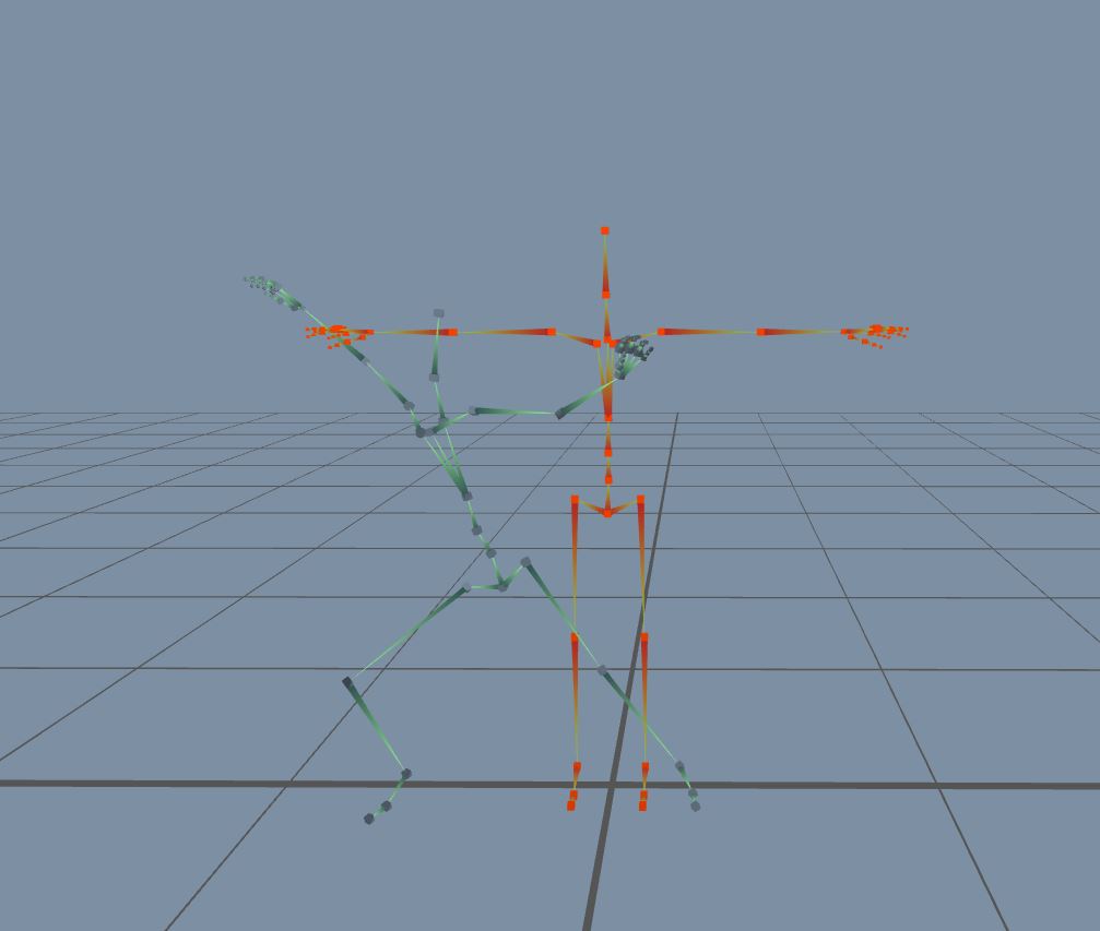

OK. I've studied this part of code thoroughly and admit that above I was wrong a bit. Here are the conditions under which imported animation is considered as "native" and applied directly to built-in model:
  • Skeleton structure is identical to our model excluding joint names. That is, number of joints and their connections.
  • Bone proportions match default proportions of the built-in model.
Given that, a non-retargeted animation previously exported from Mocap Studio will be open "normally" (without side-by-side skeleton) if only actor's height was adjusted, and specific proportions have not been touched.
We'll fix this eventually to work with adjusted proportions as well.
However, if you plan to use the Open Animation function for animation editing, I do not think it's the right way. It would be better if some basic editing features were included in work with projects. I welcome you to share your thoughts about this (once more).
As for retargeting of arbitrary animations, Mocap Studio has not ever been minded by us as such tool. If we find worthy to advance into this area, it will probably be a separate product.

I guess what you are getting at is that PS Eye recordings where the actor scaling doesn't basically self adjust when opened, makes this ability unusable?
I haven't tested this on my own with the Kinect 360 to see if what you stated about changed proportions affects this functionality, but what I gather is only Kinect users have this ability as of now in other words, because there is no way to track properly with PS Eyes recordings without adjusting many of the actor proportions correctly first and I really don't see where default proportion will track as well with Kinects either, but I am not a dedicated user of them.
What if after PS Eye tracking with adjusted proportions, they are reset to default before exporting? I will check and find out and post the findings.
As far as the so called "pre-offset" shown in the previous video, that is very handy for slight corrections before export, this doesn't work the same in the original program project editing as it is shown in that video, where the underlying bone trajectories remain correct after "offsetting", but again, I can't try it myself to find out.
I understand this isn't the primary conception from iPi, but these are handy features that you can see work for one setup, but not the other, I think you could agree with that, and if it could be configured to work consistent with each camera choice it would be nice, but as far as being a separate purchased functionality, you can just leave it out then, because I will never use a Kinect One, or any other depth sensor and will just work with it as I have been, it's just a shame.
I you have any questions, please let me know directly.
Thanks for checking it and your reply.
No, it still doesn't reopen on the default iPi skeleton after resetting proportions to default.
How did you reset the proportions? I guess you did it manually by moving sliders near to default positions, as there is no Reset button for that. However, the behavior I've described requires match with high precision, so manual editing usually don't fit.
If you save the default actor appearance (for example, after Mocap Studio has just started and no project is loaded), and then load it into an existing project, and then export animation - this animation should be "compatible" with Open Animation.
Anyway, take all the above as pure experiment for interest. There is no sence in making those manipulations just to be able to open animation in Mocap Studio. Because there are no features in Animation mode that are not available in Tracking mode. What Joe shows in that video is a simple editing capability - apply a fixed relative rotation of a single bone to all frames in ROI. This is not a special "intelligent" pre-offset feature of any kind. Just that simple - duplicate a bone's rotation to selected frames. It works exactly the same way with projects.
All joints Joe touches in the video (clavicles and neck) are mostly not affected by the tracking, so their rotation is almost static throughout an animation. Thus, setting fixed rotation for such joint does not lead to a significant loss of an animation, but indeed has the effect of "offsetting" rotations of its child joints (arm or head). If you make the same operation (Ctrl+B, Ctrl+Shift+V) for any "active" joint like shoulder - you'll see there is no magic pre-offset, the shoulder will remain fixed as though it's plastered.
So, there is no feature we're hiding from users for some purpose. That's just an inventive way of using existing editing features. Although, I am not sure it's that useful as Joe states.
