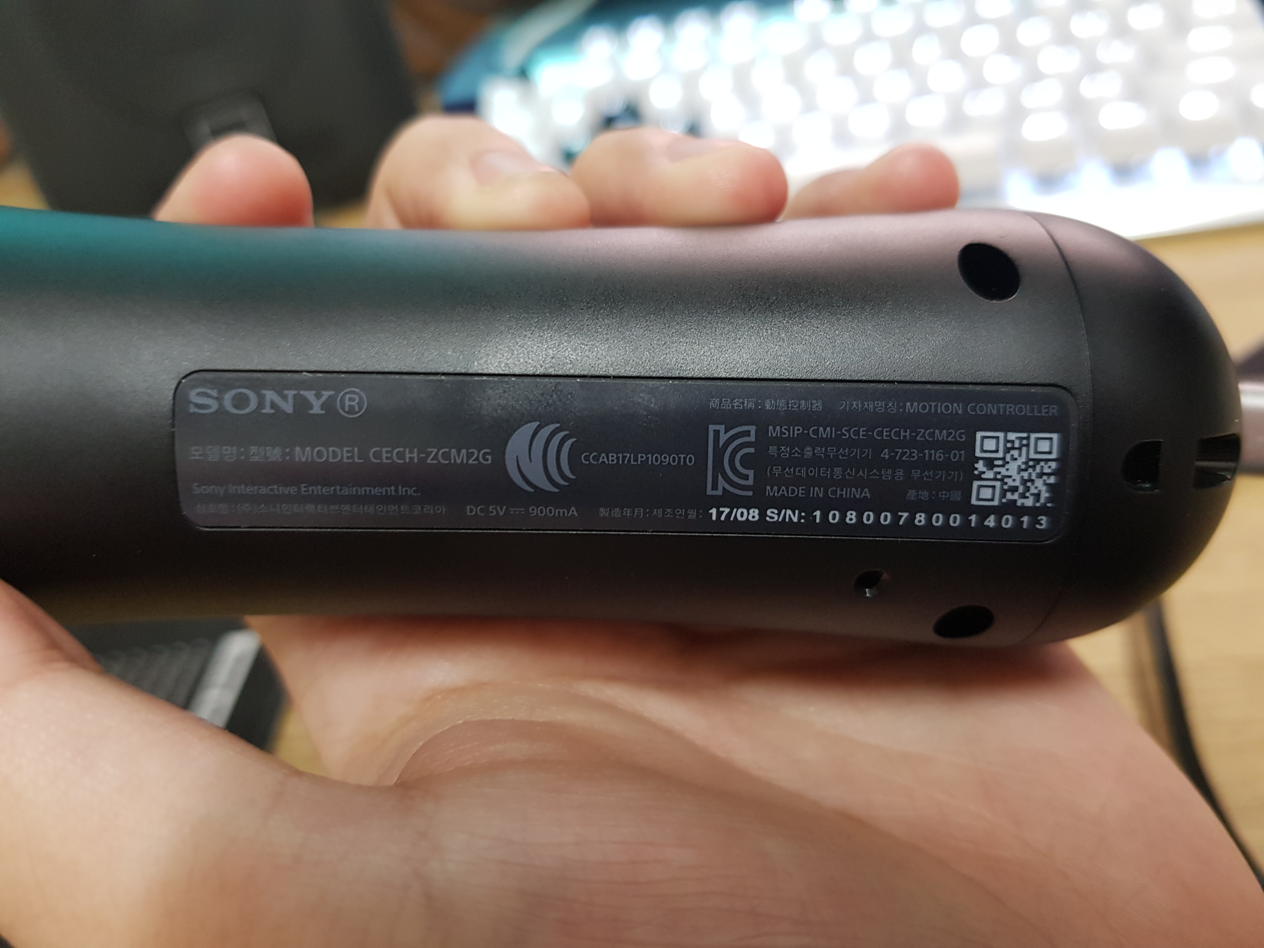

Also, please take a photo of the back label of your PS Move.
PostPosted: Fri Feb 02, 2018 5:36 pm
Joined: Fri Feb 02, 2018 8:12 am
Posts: 7

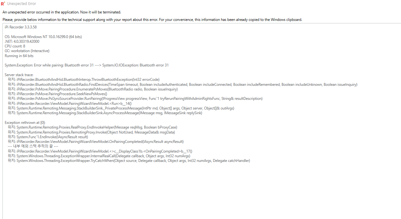

So I tested today.
Recorder detects PS Move, but recorder crashes on 'Seeking of new bluetooth devices' after few minutes.
Here's screenshot.
PostPosted: Sun Feb 11, 2018 6:07 am
Thanks for your input. We'll continue investigation of this issue. I'll let you know when we have some results (for instance, another beta version).

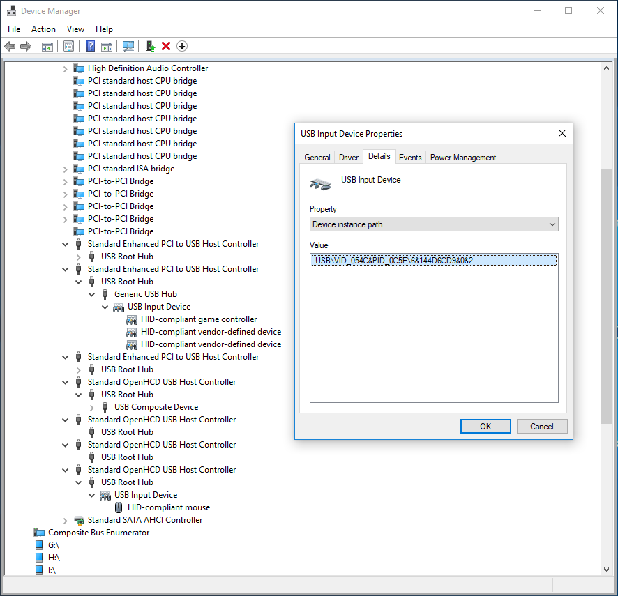

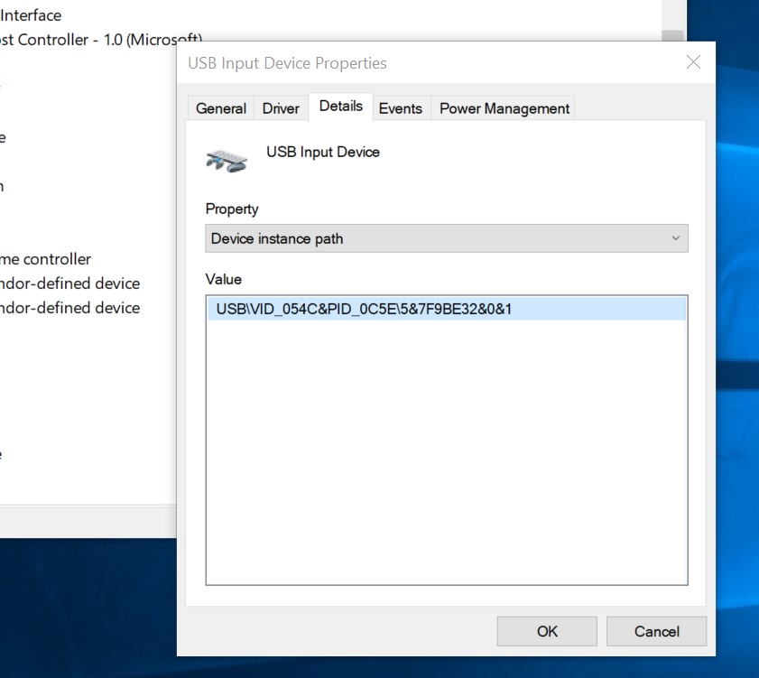

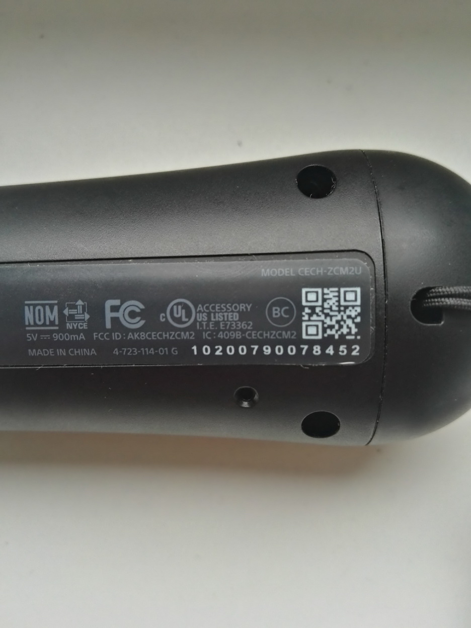

Hello, I have the same issue with new ps4 controllers (CECH-ZCM2U). The older PS3 controllers (CECH-ZCM1E) are recognized with no problem on the same computer. Any news on that field? Is there any way to try that special version mentioned above?

Sorry, no news here. I'll PM you a link to beta but seems it only recognizes PS Move but still does not allow to complete the pairing procedure.

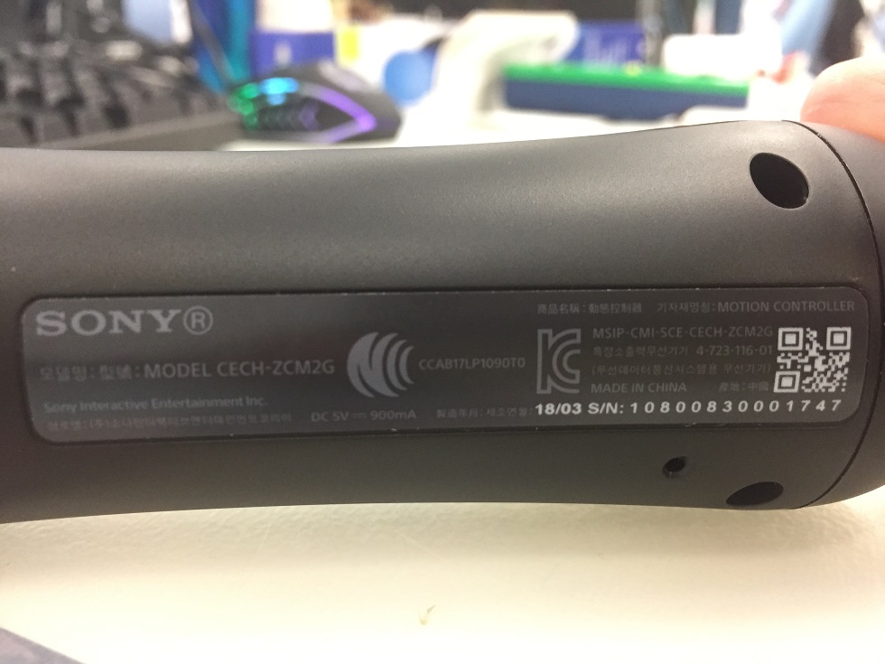

I am experiencing similar issues with the PS Move too - stuck at 'connect USB' stage. Is there already an update for this?
Please see below for the relevant info. Thank you
PostPosted: Sun Aug 19, 2018 9:50 am
Sorry, no support for CECH-ZCM2 series yet.
