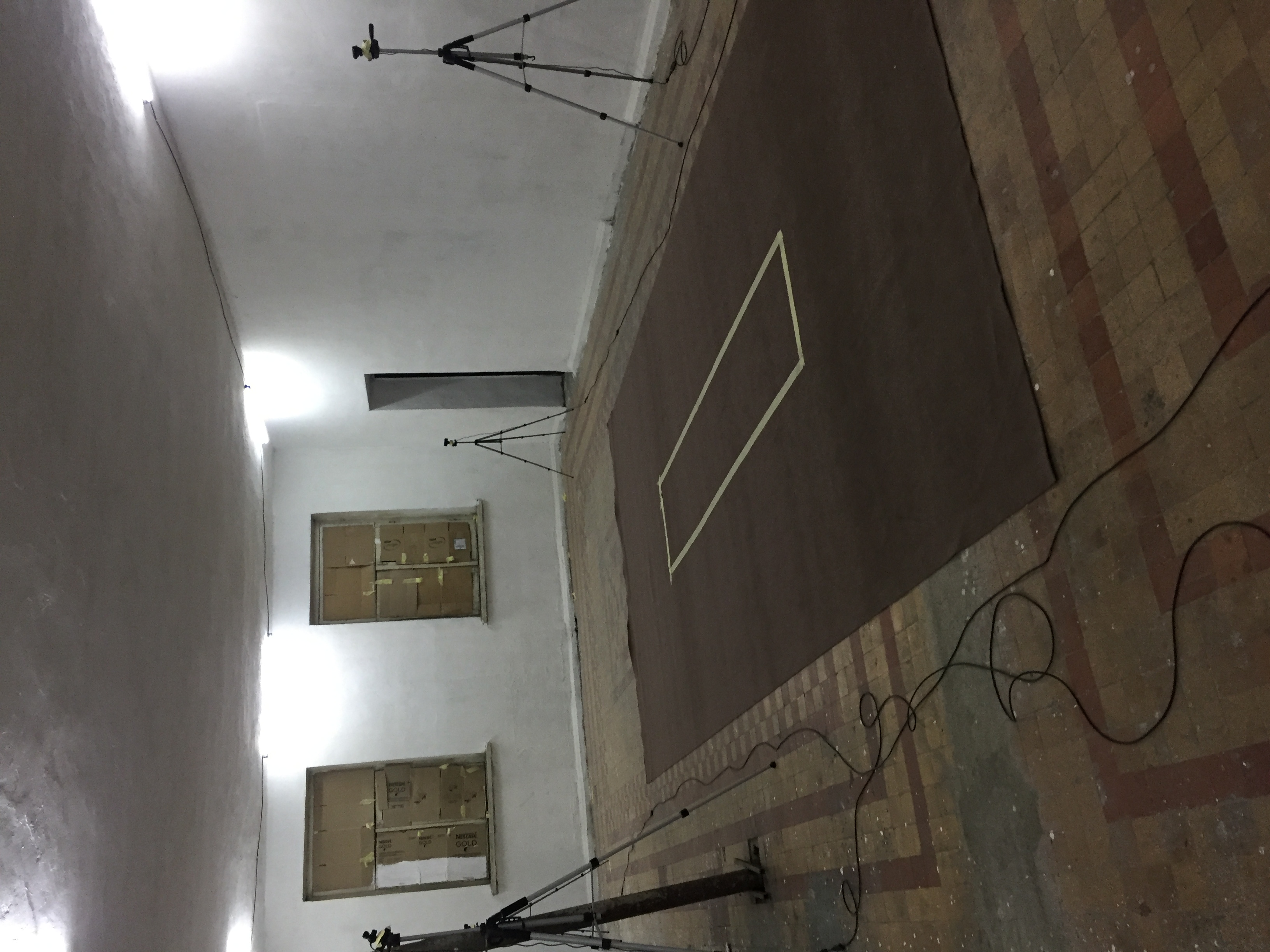

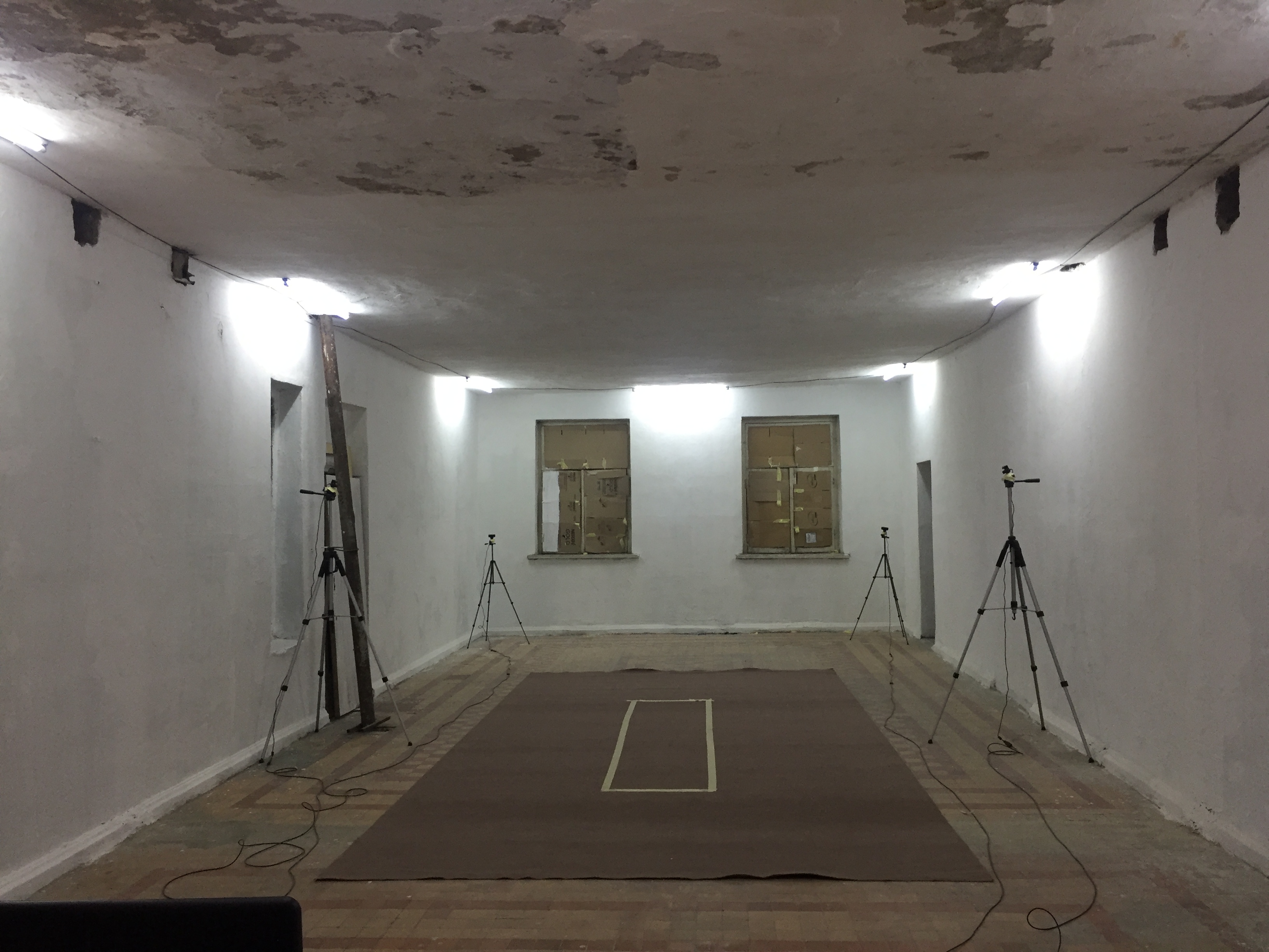

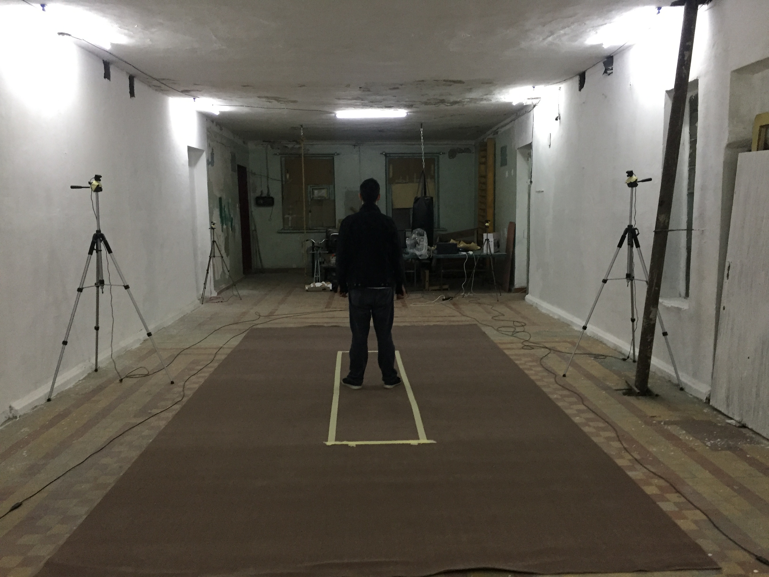

It’s been a while. I was hoping that I would be able to just thank you again and send some samples of successfully captured motion, but unfortunately I couldn’t get further than calibration. That’s where I’m stuck at this moment. Really desperate... I rented some space (I was talking about it in earlier posts). It’s 12 meters by 5,5. I’ve got 6 cams, 4 in each corner and 2 in the middle of the space as side view cams. In a word then, what I can’t find out is how to record the calibration video so, that light sources weren’t visible and the brightest point was tge MagLite I’m using... I tried both with darkening cameras from ipirecorder and turning the main lights off (8 LED horizontal lightings around the space, can’t separate them, all of them are turning on and off together, so they’re useless for a calibration), replacing them by a bit dimmer warm lighting, but I cannot hide the lighting source... If I cover the light source with some barrier then there’s not enough light in the room and I can’t make the background evaluation before the calibration recording, because all screens are just showing the black color. And in the second case there’s a loght source visible on at least 3-4 cams and it’s stronger than then the maglite point...
Maybe there’s some device I can use or something else I’m not aware of... I’ve got a feeling that there’s an easy solution, but I can’t get it... Will really appreciate any kind of help!
Thanks in advamce
P.S. Here are photos of the area shot from different angles
PostPosted: Thu Sep 20, 2018 2:12 pm
Hi, That's looks like an great set up to me, use extra darkening always for calibration, leaving lights on shouldn't be the issue.
Try using the mag light with some sort of extended tip, (a white ping pong ball with fitted hole cut in it, or a small semi transparent white spray cap affixed to the end of the mag light, simple masking tape will hold it in place and will work to keep the light visible from all angles to the cameras), also attach your light to a 3 ft (1 m) dow, or 1/2 pvc pipe works well and stay as stationary to one spot when looping the light around, you can reach out with body too, as long as the light glow is always visible to all cameras, or it will want to jump to the larger lights and stay there.
Try also using a much lower path with the light, it isn't necessary to make high sweeping cage motions for a good calibration, stay off the floor only 2 to 3 ft. (1 m max.) when doing only a 3 m x 3 m circle for perimeter, one more time around same track, but touch the floor at 4 spots, front, side, rear, side, once more around 1m off the floor in 3 m x 3 m circle, and stop path at touching the floor in the middle.
Don't move the light too fast, and let it remain on floor touch for a few seconds, visible to all cameras in each touched spot, very important. Takes approx. 2000 frames +/-
Remember to set cam #1 to its measured real world height, let others fall where they will should be fine, don't muck with other individual camera preciseness to real world, it will get it very close on its own, 1 to 2 cm difference is nothing per camera. Your height should fall with 2 cm of actual once in Studio for tracking, you may though have to increase the Actor height to get the colors auto detected, but then return it to your actual height before hitting refit.
Awesome set up, should work fine, maybe side cams could be a bit higher, but if it's working that way, up to you on that.
Object of the light path is to keep it visible the whole track to every camera, if it jumps to the brighter light, it won't jump back off it, so basically don't let it jump off your mag light glow, by keeping the path lower to the floor the tracker shouldn't even want to jump to the higher lights, unless of course you mess up and occlude the mag light for even a second, it will jump off it.
My lighting is similar, when I record at night, and I have no issues with calibration with all lights on, extra dark setting, low light path and don't occlude the mag light ever.
It can be a bit finicky until you get the process worked out, but then after that it only takes a few minutes to calibrate and know what to expect without many issues.
Hope this helps and next time you can show some cool animation video :)
