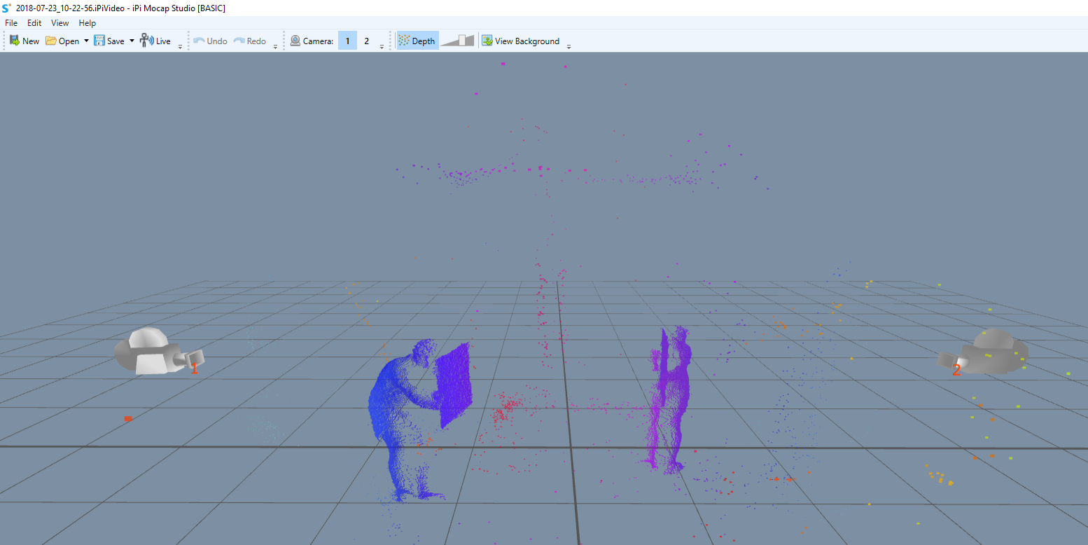

Something else what I experienced and maybe it help you guys understand what is happening exactly. (Or maybe this is a new problem) Today I started to use the board calibration method because it is much easier and faster than the light method. I made a recording in the morning and I experienced a big difference between my cameras depth information. The difference is in space, not time! (After this I made 2 more recordings and they were perfect)
Is this the same issue or something else?

Interesting news for my last issue. I checked again the wrong calibration file and when I run the board calibration it ended up being good. So I send my original and wrong iPiCalib file too, maybe it is help in the investigation.

This looks familiar to me. In my case, I noticed a long time ago that this happens when iPi Mocap Studio gets confused about where I'm standing and flips the capture from one of the cameras.
The trick to preventing this error is to hold the board as far away from your body as you can--you don't want the data to get confused with your legs (like what's happening in your screen capture--this is most obvious in the right-side figure.) Also, hold the board in the middle of each side--avoid holding it anywhere near the corners. The tracker really needs to see the corners clearly for accurate calibration. From the tracker's point of view, the board needs to 'appear' to be floating on its own, so keep your body away from it.
If you're using a 180 setup, you need to hold the board with one had and stand to the side of the board. Hold it out with your arm straight.
Another very important thing to be aware of is how you move the board. Move the board with your body, not your arms--you don't want to pull the board near your body and confuse the tracker. Also, move board from side to side, not just front to back. (I also rotate the pitch and heading angle of the board but not too far because the board might bounce the IR rays away from the camera and hinder accuracy. I think I was told this angling motion doesn't matter too much, but I still do it anyway.)
From what I've been told, the back and forth motion is the most significant motion for accurate calibration, so take a few steps forward and backward if you can.
In short, proper board handling should make it very obvious to the tracker what it should be trying to align for each camera.
The material you use can also impact successful calibration. Make sure the board is rigid and has a matte surface. Poster board is NOT suitable because it's too floppy. Color is okay but avoid black because it can absorb the IR rays. White is okay if the room doesn't have really bright overhead lights or direct sunlight coming from the windows. Gray is probably best. FYI, I like to use a large sheet of white foam core board which you can pick up at any art supply store. It's very light weight so I can easily hold it up with one arm, and rigid enough for accurate tracking.
If you follow the above, board tracking should work perfectly every time. Good luck!
