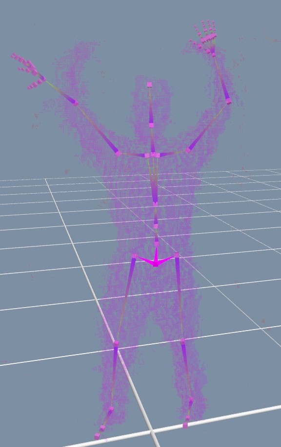

Earlier I mentioned that the right arm seemed to be 'stiffer' than the left arm. Here's a good example of where the right arm does not want to do what the left arm is doing:
This is probably related to the shoulder issue--it looks like the right shoulder is rotating forward when it should be rotating backward.

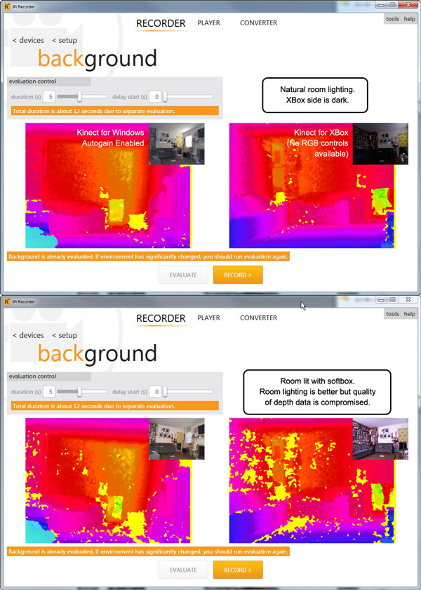

I had no idea that using Kinect for Windows gives you many more options for tweaking the RGB image.
It's a dreary rainy day here in Los Angeles and our room is looking quite dark on the Kinect for Xbox side of the iPi Recorder panel. On the Kienct for Windows side, however, everything is very bright and visible--even without tweaking.
Now I'm thinking we should order a second K4W device. But for today, we're bringing in a softbox to light the room.
Just to be sure, the latest implementation of head tracking does utilize RGB for assistance, does it not? If not, I won't bother with the softbox.

Here's something that may interest users.
As mentioned above, the RGB for Kinect for XBox was much darker than the RGB data for Kinect for Windows, so we decided to bring in a softbox to light the room (just in case room lighting has effect on the new Head Tracking system.) The result was surprising.
The softbox naturally improved the quality of the RGB data but it degraded the quality of the depth data.
This is apparently caused by the light from the softbox relecting on shiny surfaces in the room (our floor is polished wood, there are framed photos on the wall, and over on the left are many books with shiny spines,) which is apparently interfering with the IR from the Kinect sensors.
Obviously, we don't want to use the softbox for this shoot. Just one more thing to keep in mind when setting up for a shoot. :)

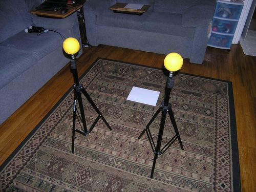

We're using ReconstructMe and Agisoft PhotoScan. We got the idea to try this ourselves after reading 1K0's blog. We haven't spent a lot of time with either program yet because we're busy trying to finish our current movie. Here's what we know from brief testing so far.
ReconstructMe is interesting because of the immediate feedback and results. The detail is not hi-def and you'll want to retopologize the result, but the result really is not bad for a base to sculpt from. (Like, say, in ZBrush or 3D Coat.) IMO, the main issue is lack of texture data.
PhotoScan is much more capable but also requires a lot more work. It does not use Kinect--you need to capture a series of photographs of your subject, and the software will reconstruct the object from the photos with a high-res texture applied. I found that the most time-consuming part is setting up masks for the object, so you may want to do your shoot in an uncluttered room.
BTW, here's our scanning 'rig', inspired by what we saw on 1K0's blog:
I'll post more info in our blog whenever we have time to actually use this tech. For now, I want to stay focused on iPi DMC 2.0 so we can finish our movie. (Besides, it's kind of OT for this forum.) :)
