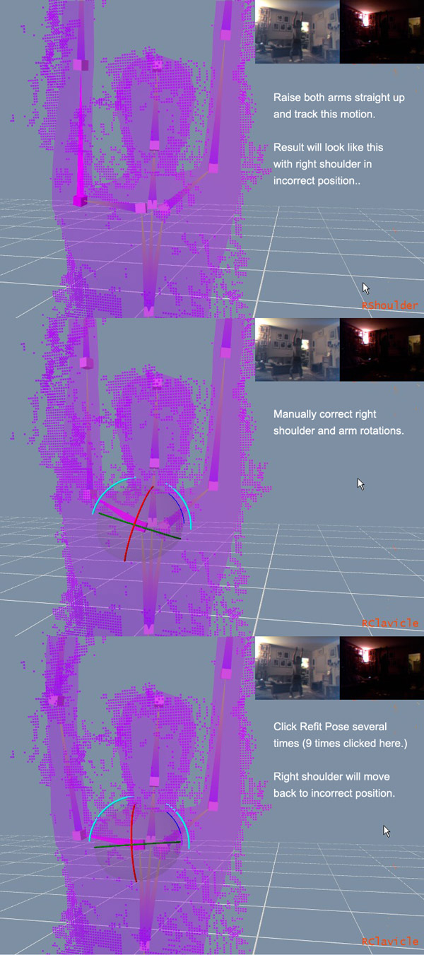

I revisited Studio today to see if there wasn't something I missed. Unfortunately, I still could not prevent the Right Shoulder and Spine/Hips errors.
However, I did find another way to repeatedly demonstrate the problem with the right shoulder:

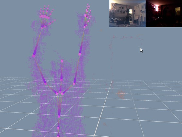

I just noticed something very strange. This is definitely a bug but I think it's a good one--at least for now anyway.
I opened a clean, untracked project for the Shoulder Test video but this time I left Enable Shoulder Tracking disabled from start. Forward Tracking was moving along quite speedily, and when it reached the point where both arms are fully raised, this time the tracker correctly tracked both shoulders!
So, important tip for other users: if you want shoulder tracking on, leave Enable Shoulder Tracking off. At least for now. (Note: The current build as of this post is 2.2.1.145)
Here's a screen cap of frame 217, arms at max height. There is still something funny going on with the right arm--we'll just have to deal with that--but the right shoulder does look good now.
