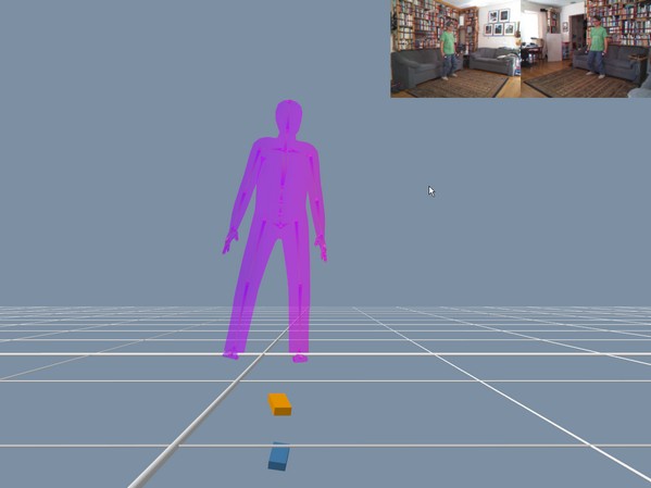

After working with the new build for a few hours, I'm finding there are still occasional problems with the spine. Here's an example tracked with Stiff Lower Spine enabled:
What's interesting is that the point cloud appears to be leaning a little to the the figure's left even though I am pretty sure I was standing straight up. My suspicion is that the shape is being distorted somehow and made to lean to the left slightly. Tomorrow I'm going to try a few experiments with different camera positions and see if I can improve the figure symmetry.
To be certain I'm not actually leaning to the left, I will set up a separate video recorder and record head-on while capturing with the two Kinects.
For tonight, I'll try different settings in Mocap Studio and see if I can improve this in tracking.
PostPosted: Tue Feb 26, 2013 12:06 am
Here's something else that's interesting. If I set Trajectory Filter to 0, the figure's spine straightens up.
The Actor is still leaning slightly to its left and that's because the point cloud is distorted/skewed that way. But besides that, the spine has straightened out with this setting. And when I switch Trajectory Filter back to 1, the spine curves sideways again. (As in the previously posted image.)

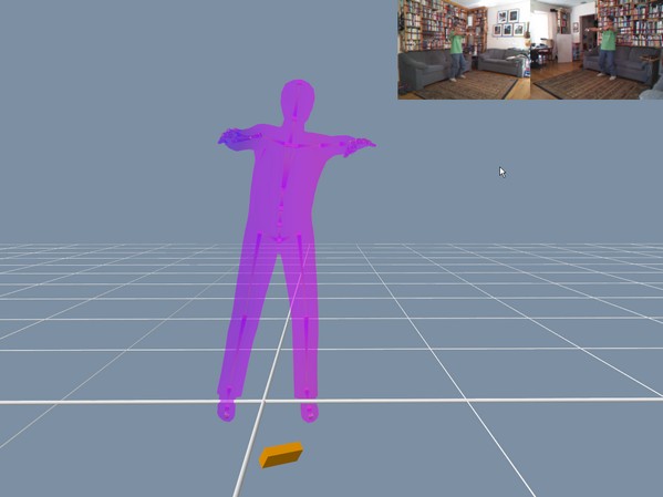

PostPosted: Tue Feb 26, 2013 12:22 am
Yes, the point cloud is definitely leaning to the left. When I disable Enable Ground Collision, the left foot sinks well below ground level. I'm guessing this must be a calibration problem. The ground plane may be horizontally level but the orientation of the point cloud is apparently rotated off-level slightly.
I'll record completely new tests tomorrow to see if this error is repeatable. Maybe try switching position of Kinects to see if this make the figure lean to the right.

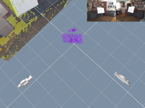

PostPosted: Tue Feb 26, 2013 12:57 am
Looking at the setup I used today, I'm wondering if the point cloud distortion is due to user error--I was using the 90 degree configuration but on closer examination of the scene, my two Kinect sensors may actually have been positioned slightly wider than 90 degrees, which I believe is 'out-of-bounds' for proper calibration. (The suggested range for this configuration is between 60 and 90 degrees.)
That's what I get for trying to rush things. :)
Tomorrow, I'll try testing with a narrower angle and also with the near 180 degree configuration.
