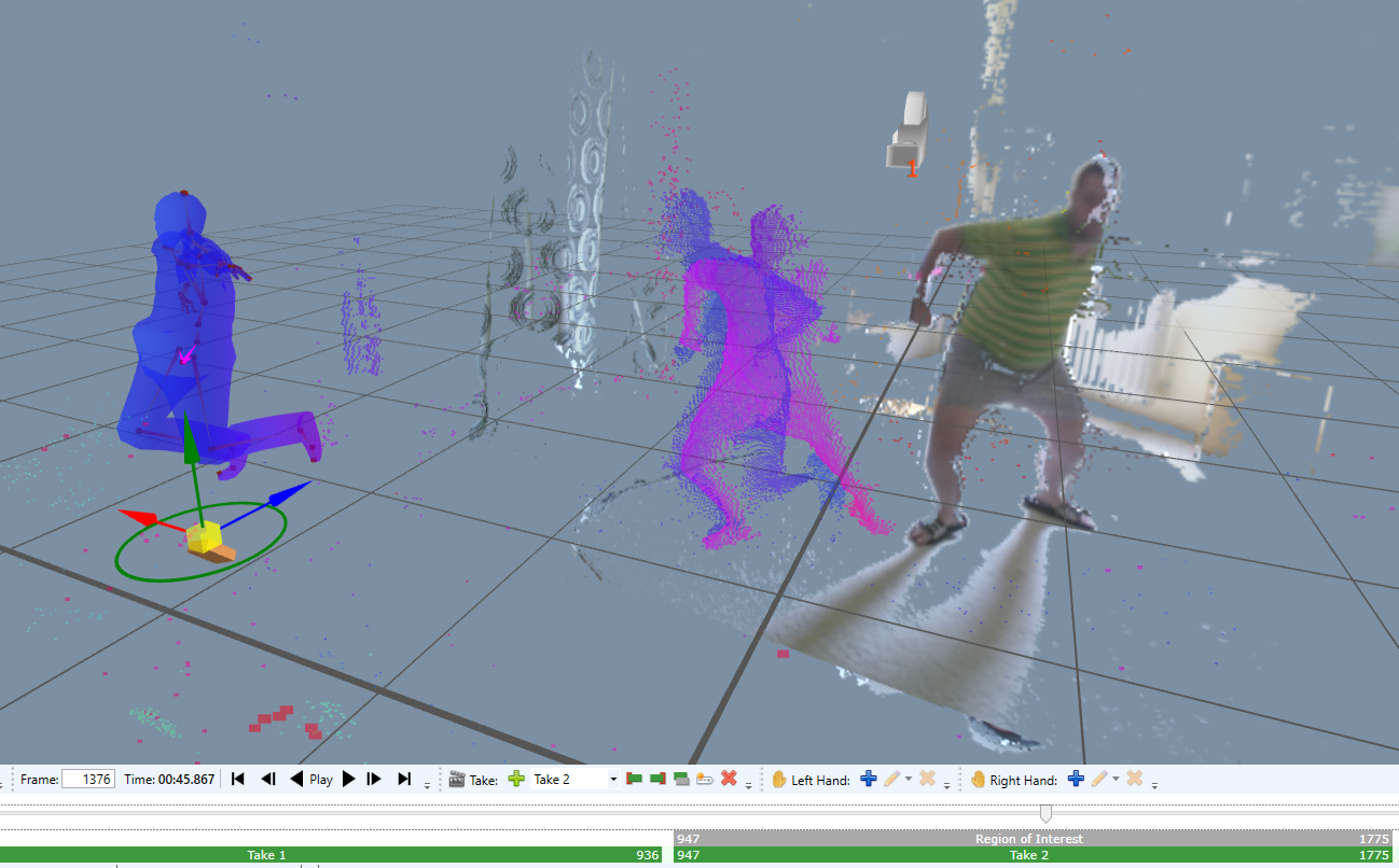

Very often when I am recording and try to track, the depth information timeline per kinect camera seems to be out of sync. One camera is either behind or before the other camera in terms of timeline. (I attached a picture "difference.png") As the picture show I have a big difference. What is the problem? Can somebody help me with this? These computers not the newest but they should be powerful enough.
Thanks for the help guys!

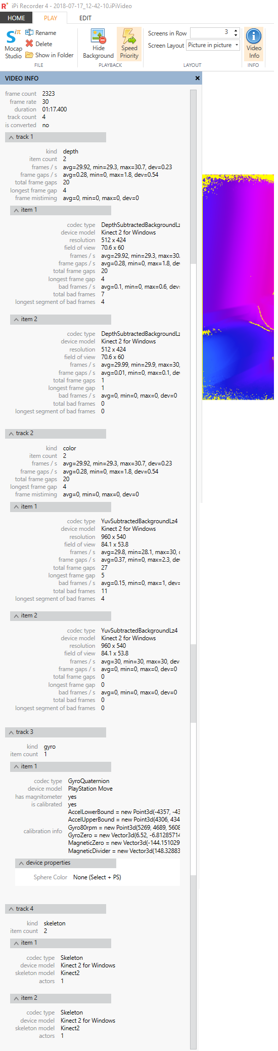

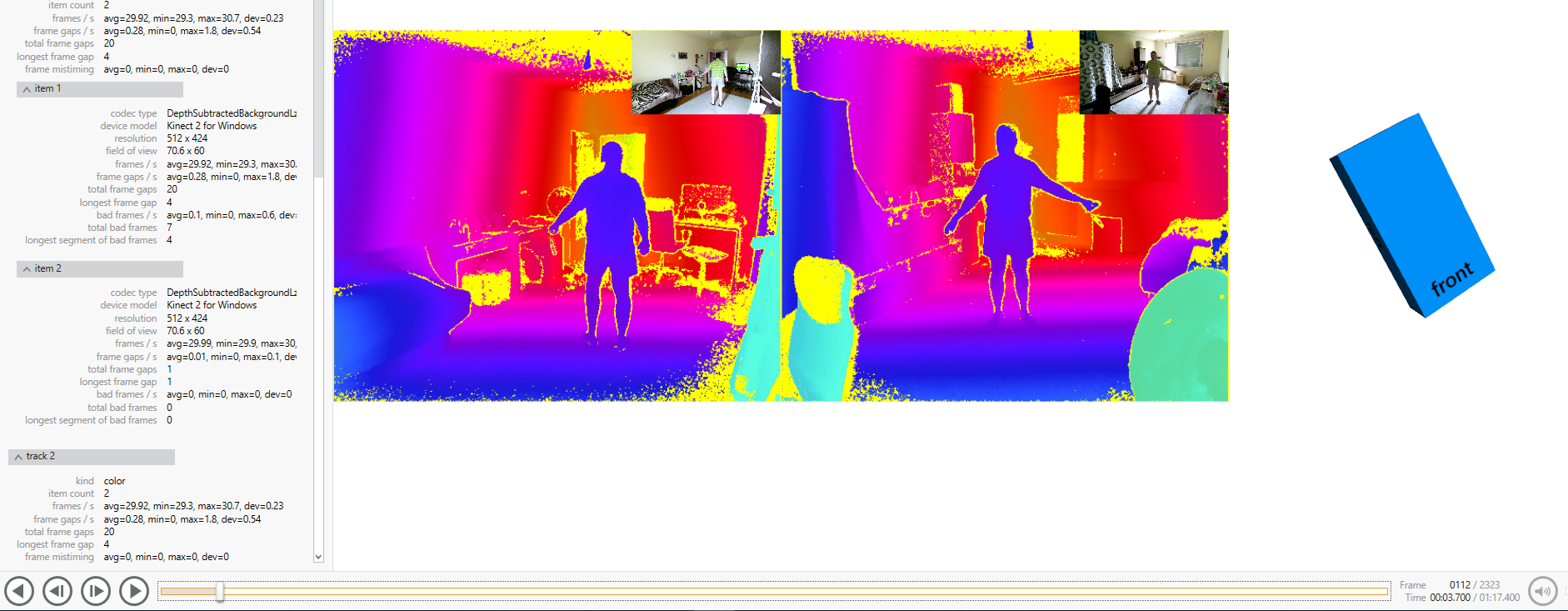

Hello!
I opened all track information under the video info section and i made a screenshot for you. I see the delay from the 3rd second.

I see there are some issues with first recording - a few frame gaps and bad frames, although not seeming critical.
Can you please provide similar screenshots for individual recordings before merging into one? That's what I requested actually.

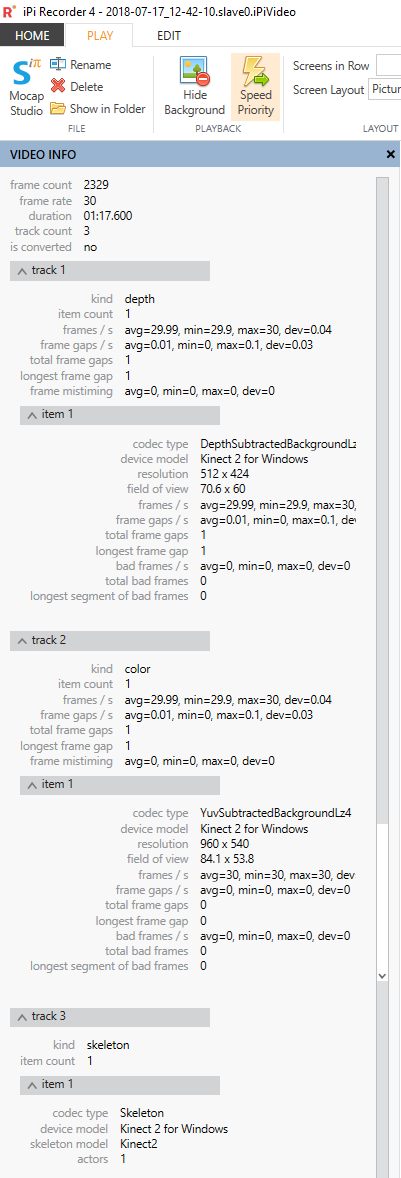

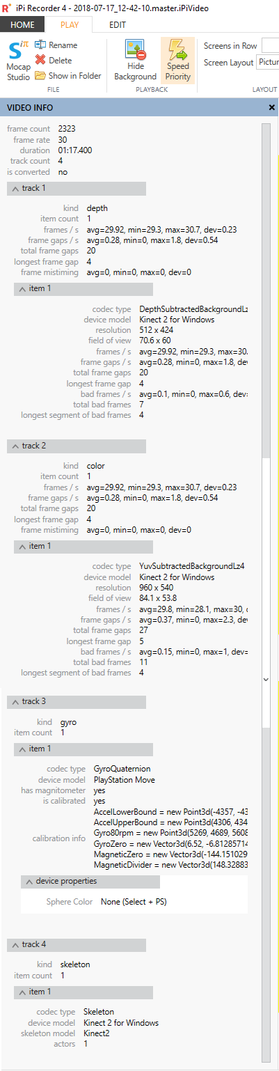

ohh okay sorry for the misunderstanding. Here are the individual screenshots:
File comment: master
File comment: slave

Looks like the Laptop is running better than the Desktop.
Seems that would be the other way around.
