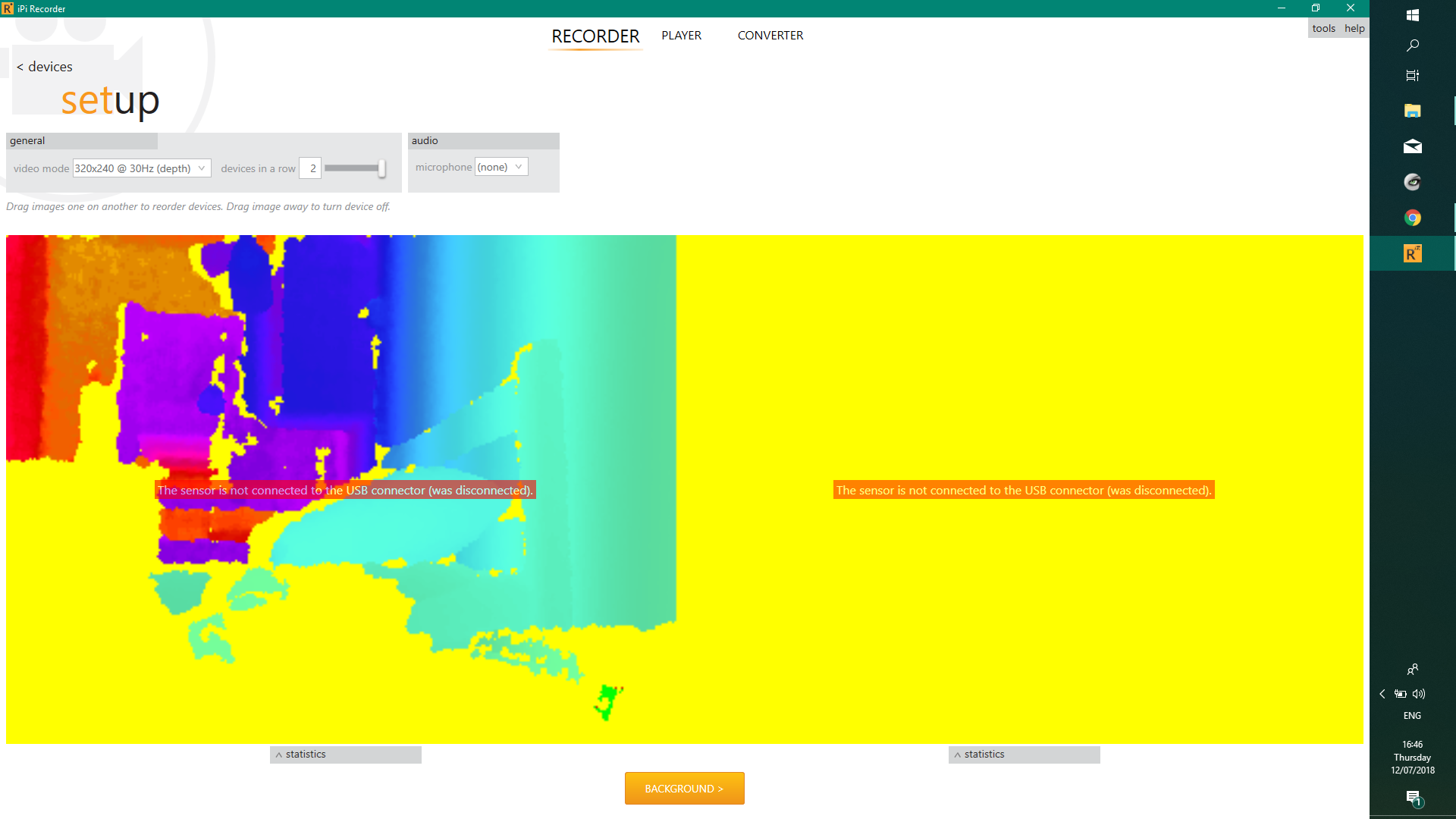

I have some issue to use Ipi Recorder 2 with 2 kinect 1. I try independently each of them and it's working perfectly but when I try to use them in the same time, it's working first and then there is a red message saying ''the sensor is initializing, please wait'', it leave and come back all the same, and when I launch the setup the video stop in both part.

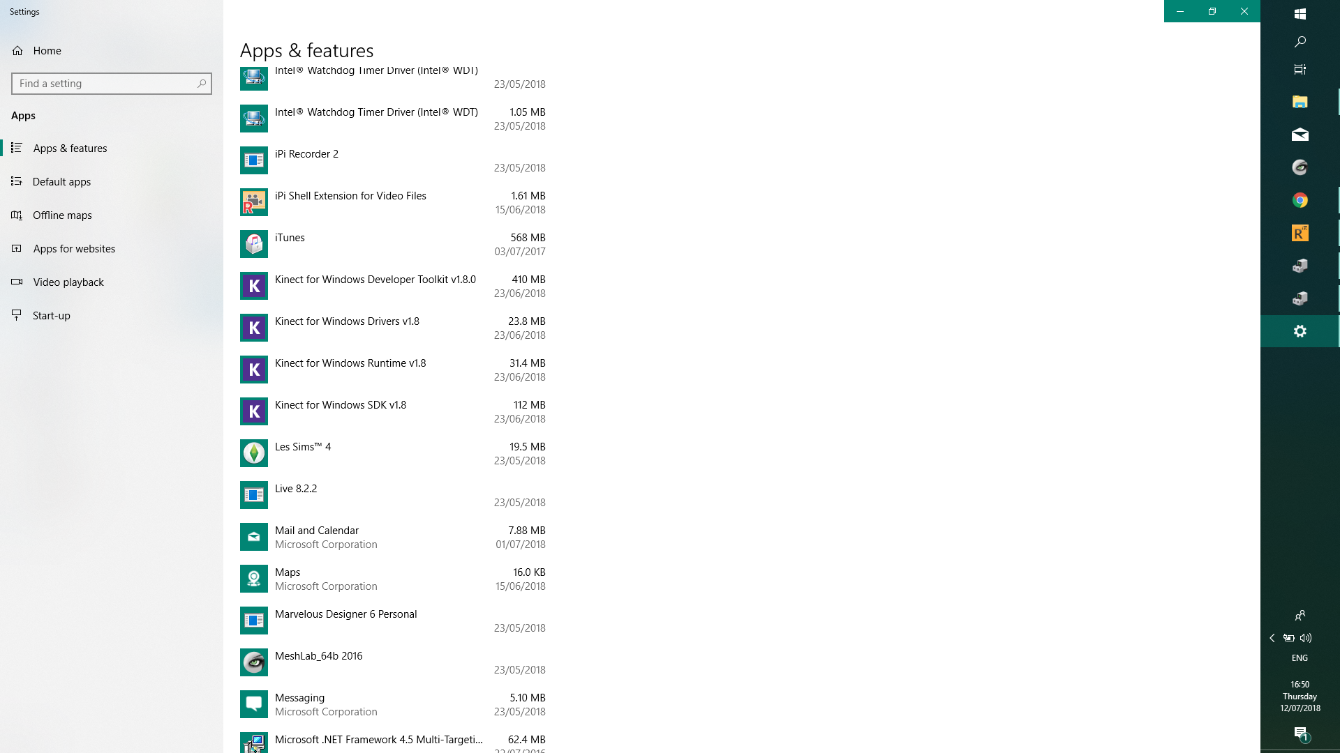

Also there may be a conflict caused by having Microsoft Kinect SDK and Open NI installed simultaneously. Try uninstalling OpenNI and all things containing "Kinect" in their names besides Kinect SDK.

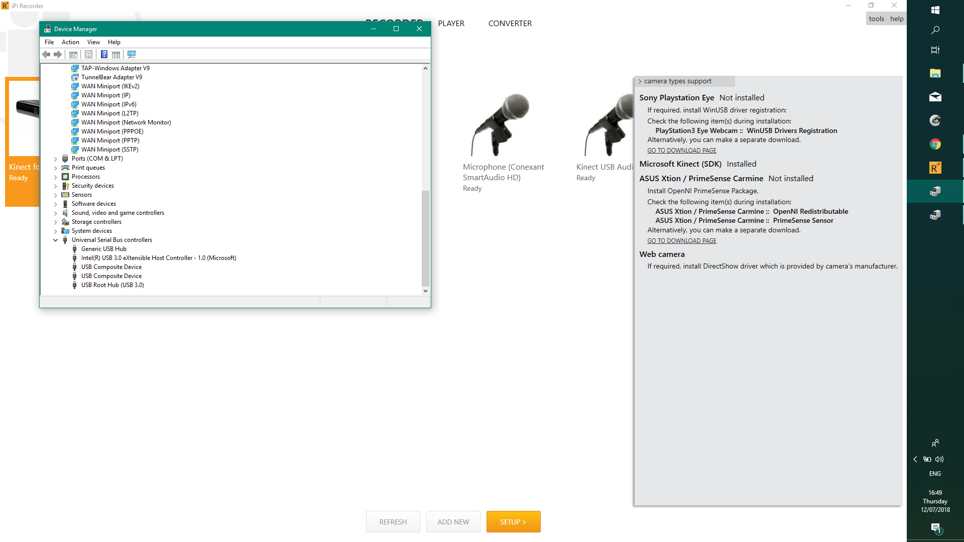

I try all the combinaison of USB ports but it's the same. I think my computer got only 1 USB controller for all of the USB ports, is that possible ? Because when I plug the 2 kinects, my computer start crashing, and I ear the sound of connect/disconnect several times + the informations inside the Device manager / Universal serial bus controller don't stop to change.

I uninstall Open NI, but it changes nothing. Should I have to uninstall all the ''Kinect for Windows'' drivers (picture 3) and only keep the ''Kinect SDK'' one ?

I recall now that Kinect v1 has known issue with recent Intel chipsets 8x series and later. Multiple sensors do not work properly when connected to USB ports of such chipsets. Here is the discussion of the issue
https://social.msdn.microsoft.com/Forum ... =kinectsdk
So if your laptop is based on one of those chipsets than you're out of luck. And there's no way to add USB controller to modern laptops, ExpressCard port is outdated tech not present nowadays.
