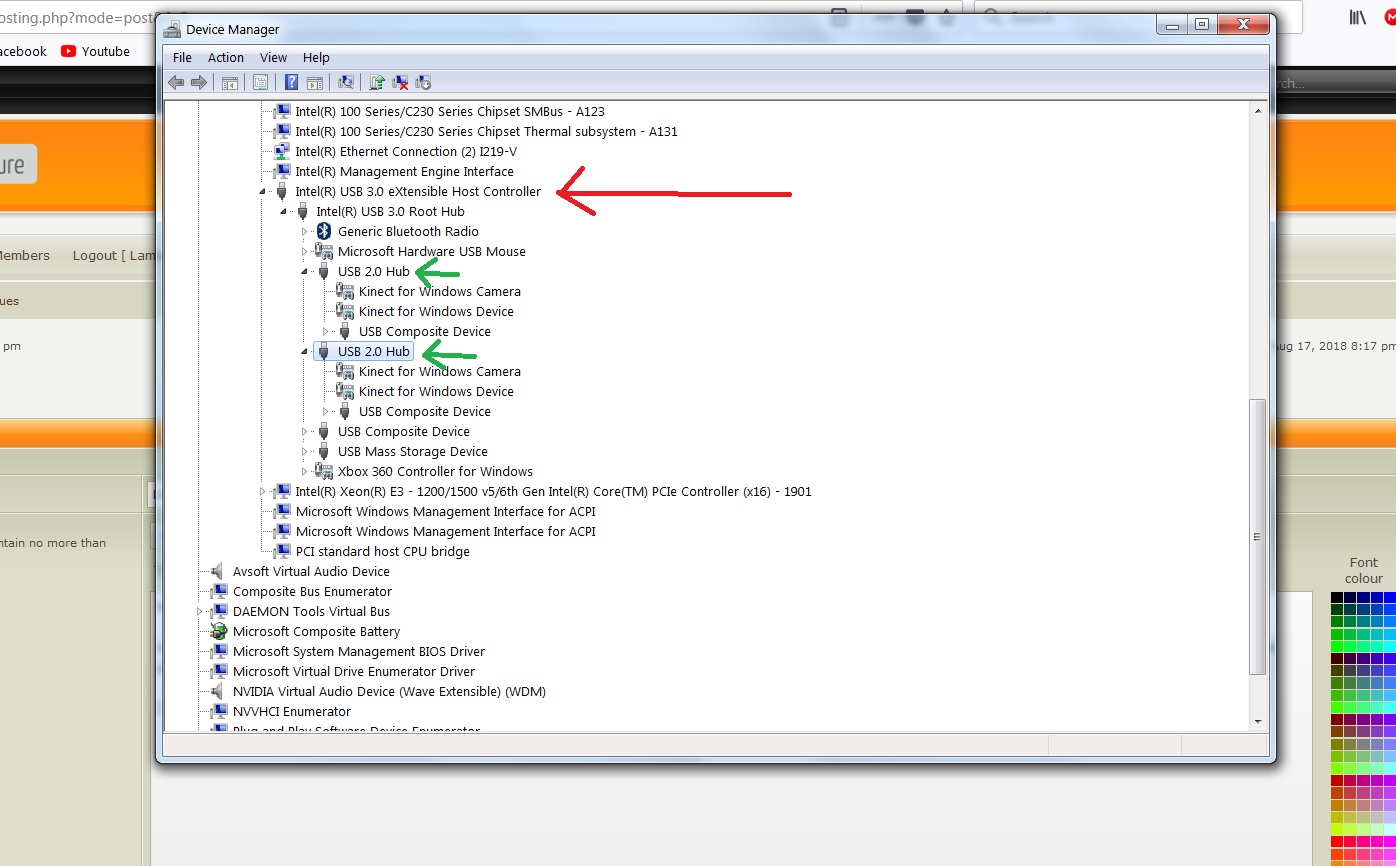

Hello you guys, I am facing a problem when trying to record with dual 360 kinects.
Up until now I was using one kinect with no problem, so I bought a second one. Both kinects work fine alone. But when I try to record from both of them, the video freezes instantly, and I cannot proceed further.
I saw on the forums that this may happen because both kinects use the same usb port.
I attached a screenshot of my device manager, with a "device by connection" view.
I can see that the USB 3.0 extensible host controller controls all the usb ports below, so no matter where I plug the second kinect, it doesn't work.
So, how do I proceed from here? Should I uninstall the extensible host controller? Is it safe to uninstall it or it will create problems on my PC?

For anyone that has the same issue with me, I solved it as follows:
I bought a PCIe express USB card, I installed it on my PC and then I plugged the second kinect to one of these new USB ports. Now the two kinects work normally together
