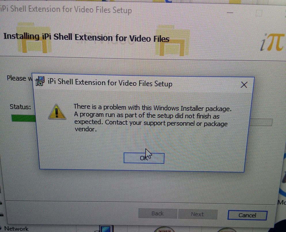

PostPosted: Mon Apr 08, 2019 2:05 pm
Joined: Sun Apr 07, 2019 2:31 pm
extension shell won't install
PostPosted: Tue Apr 09, 2019 3:29 am
It looks like .NET framework is corrupted on your system. Try running .NET Framework repair tool.
https://docs.microsoft.com/dotnet/framework/install/repair
