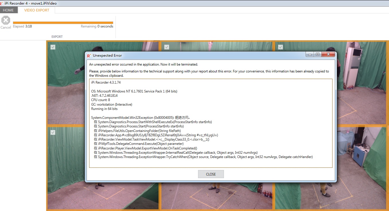

Hello ipisoft,
I encountered this issue when I tried to export the videos in Ipirecorder .
Please see my picture.
What can I do now ,please ? Please help me.
iPi Recorder 4.3.1.74
OS: Microsoft Windows NT 6.1.7601 Service Pack 1 (64 bits)
.NET: 4.7.2.461814
CPU count: 8
GC: workstation (Interactive)
Running in 64 bits
System.ComponentModel.Win32Exception (0x80004005): 拒绝访问。
在 System.Diagnostics.Process.StartWithShellExecuteEx(ProcessStartInfo startInfo)
在 System.Diagnostics.Process.Start(ProcessStartInfo startInfo)
在 iPiHelpers.FileUtils.OpenContainingFolder(String filePath)
在 iPiRecorder.App.#=zBlsgB9USJy8jT8Zf8DgL5ZiRenal6tj0iA==(String #=z_tNLygU=)
在 iPiRecorder.ViewModel.TaskViewModel.<>c__DisplayClass33_0.<.ctor>b__1()
在 iPiWpfTools.DelegateCommand.Execute(Object parameter)
在 iPiRecorder.Player.ViewModel.ExportViewModel.OnTaskCompleted()
在 System.Windows.Threading.ExceptionWrapper.InternalRealCall(Delegate callback, Object args, Int32 numArgs)
在 System.Windows.Threading.ExceptionWrapper.TryCatchWhen(Object source, Delegate callback, Object args, Int32 numArgs, Delegate catchHandler)

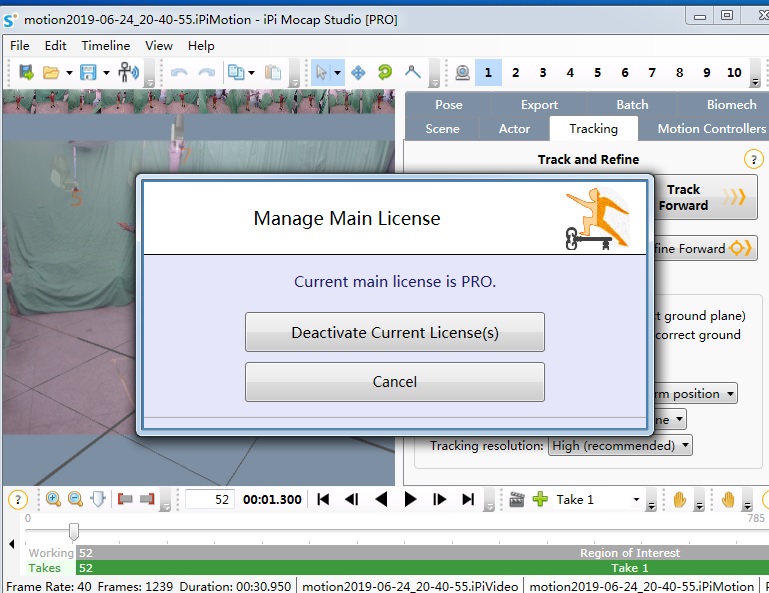

Steal ? What an arbitrary word!!
The current license is PRO!
Idiot!

PostPosted: Mon Jul 29, 2019 9:19 am
The program actually crashes after the file has been exported, when it tries to open a containg folder in Windows Explorer. So at least you have your video file after a crash.
Not sure about the reason though. Do you have national Chinese characters in the file path?
PostPosted: Wed Jul 31, 2019 6:10 am
Joined: Tue Mar 05, 2019 8:49 pm
Posts: 54
Location: Guangdong province ,China
I didn’t use any Chinese Characters in the file path. But all the AVI files exported seemed to be fine after the Crashes(playable and convertible) of ipiRecorder. It only crashed after exporting some very files.
I want to export the ipivideos for the documentary of my work only.
win x64 7 SP1
I7 4770
PostPosted: Thu Aug 01, 2019 8:52 am
Maybe there are some special permissions on the folder you are saving to?
Try disabling User Access Control - will it crash then?
