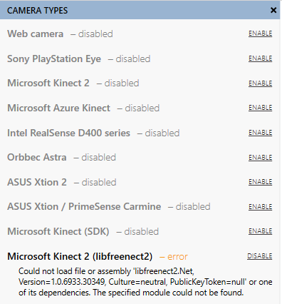

Hello! I'm trying to get multiple Kinect 2 sensors working. I've followed documentation, but I think I'm hitting a slightly more fundamental problem than those documented.
When I try to enable libfreenect2, I get the error shown below:

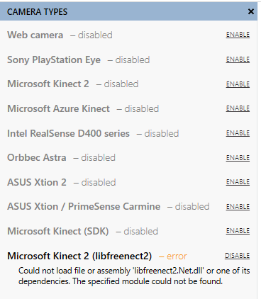

If I toggle it off/on, it slightly changes.

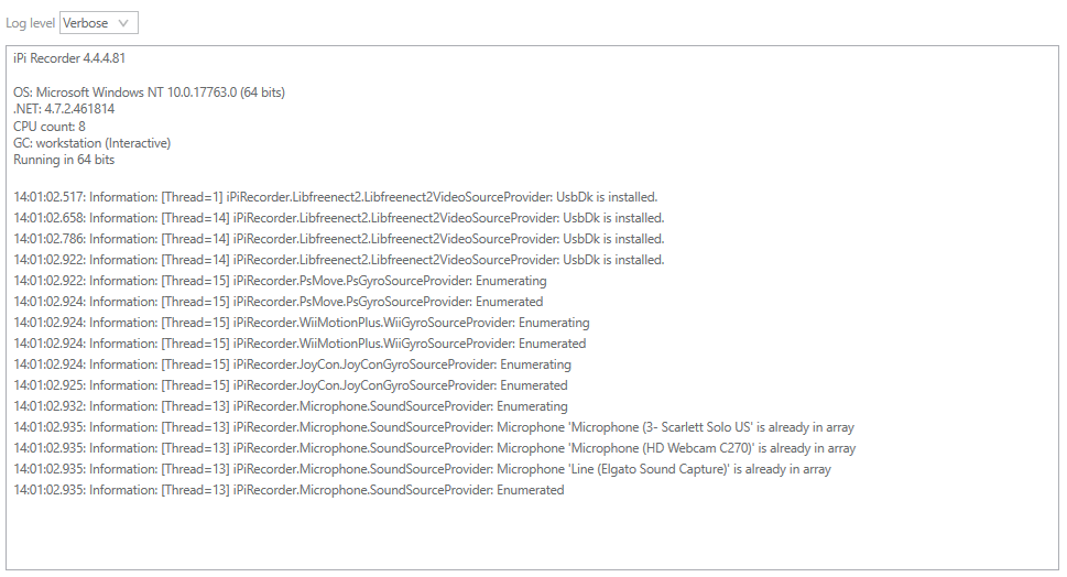

I have tried both USBDK and libUSBk and there doesn't seem to be much difference. If I disable libfreenect2, restart the program, enable verbose logging, I'm able to capture this.
I could definitely use some better errors for trying to diagnose this. ;)

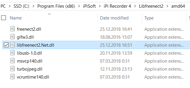

Do you have all that files in iPi Recorder installation? (see attachment)
If not, try reinstalling iPi Recorder.
If yes, download Dependency Walker utility (64-bit version) and open libfreenect2.Net.dll in it. Check which dependencies are not found (have "question" icon). Ignore those starting from "API-MS" and "EXT-MS".
