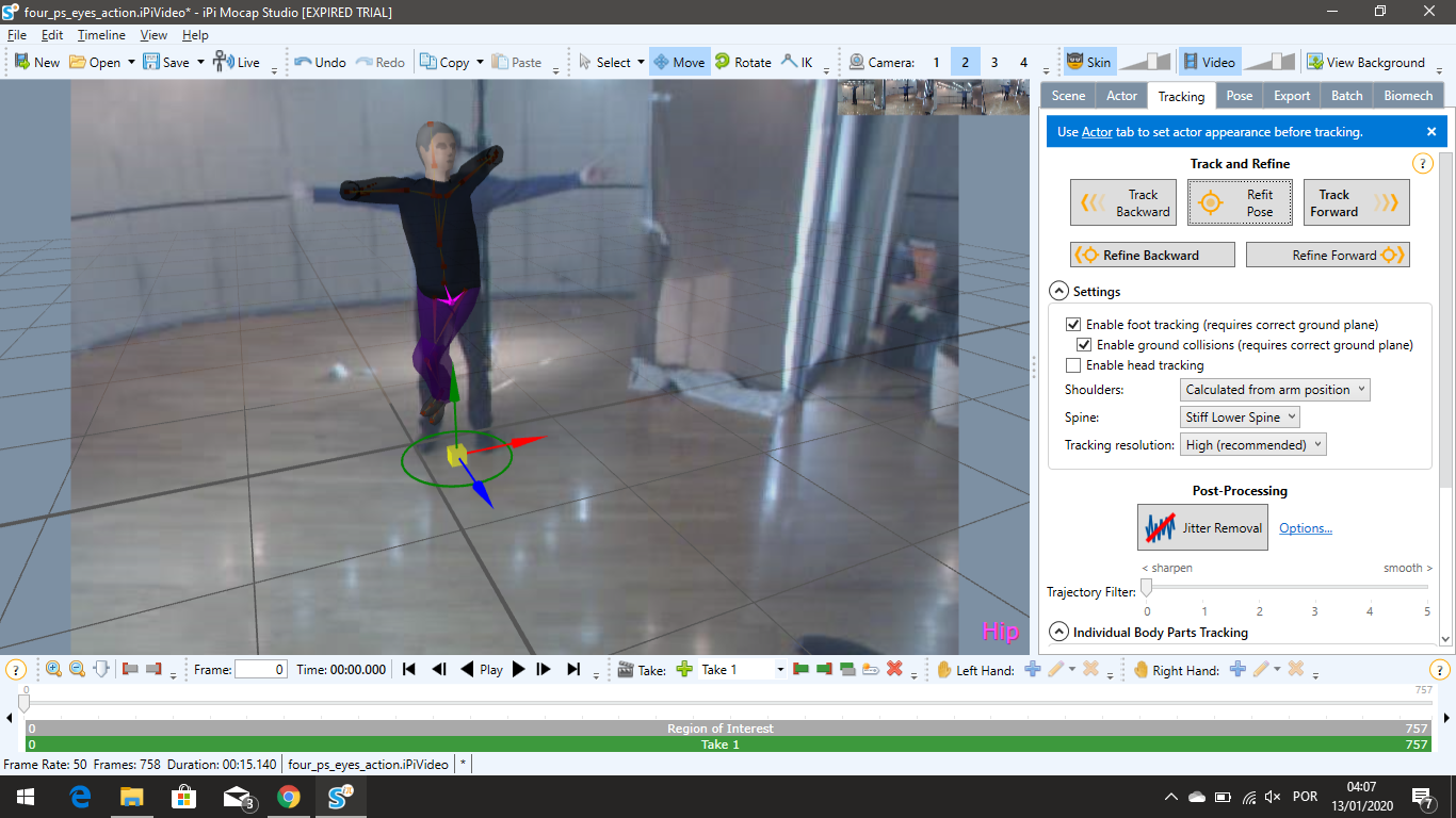

I am testing ipisoft here.. testing with sample files provided here...
http://docs.ipisoft.com/Sample_Video_an ... our_PS_Eye)
After calibrating using calibration files provided... and trying to capture from the video provided... setting actor height to 1.99m and first camera height to 1.1m ... when I press refit pose.. legs get twisted like this....
PostPosted: Mon Jan 13, 2020 12:58 am
You didn't adjust actor colors to match a video. Please read carefully this section in the docs about tracking process:
http://docs.ipisoft.com/User_Guide_for_Multiple_PS_Eye_Cameras_Configuration#Processing_Video_from_Multiple_PS_Eye_Cameras
