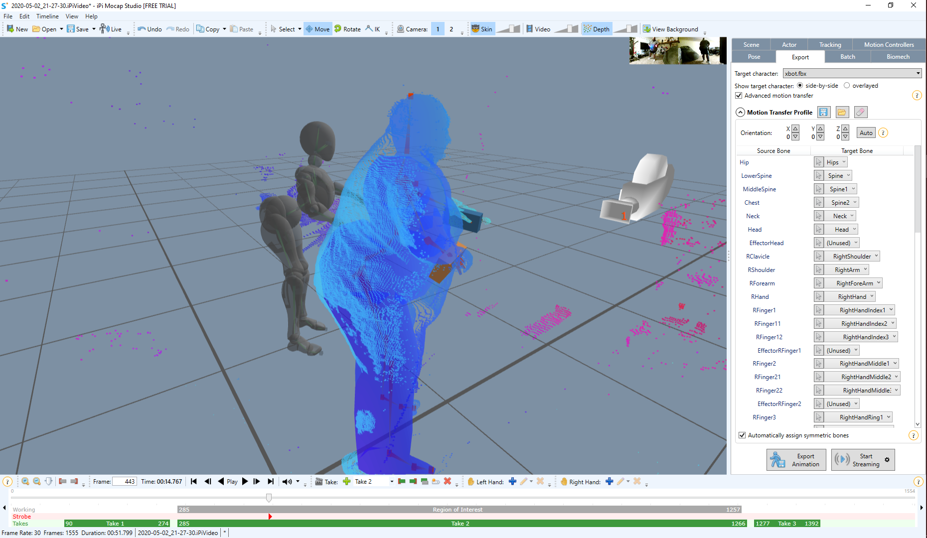

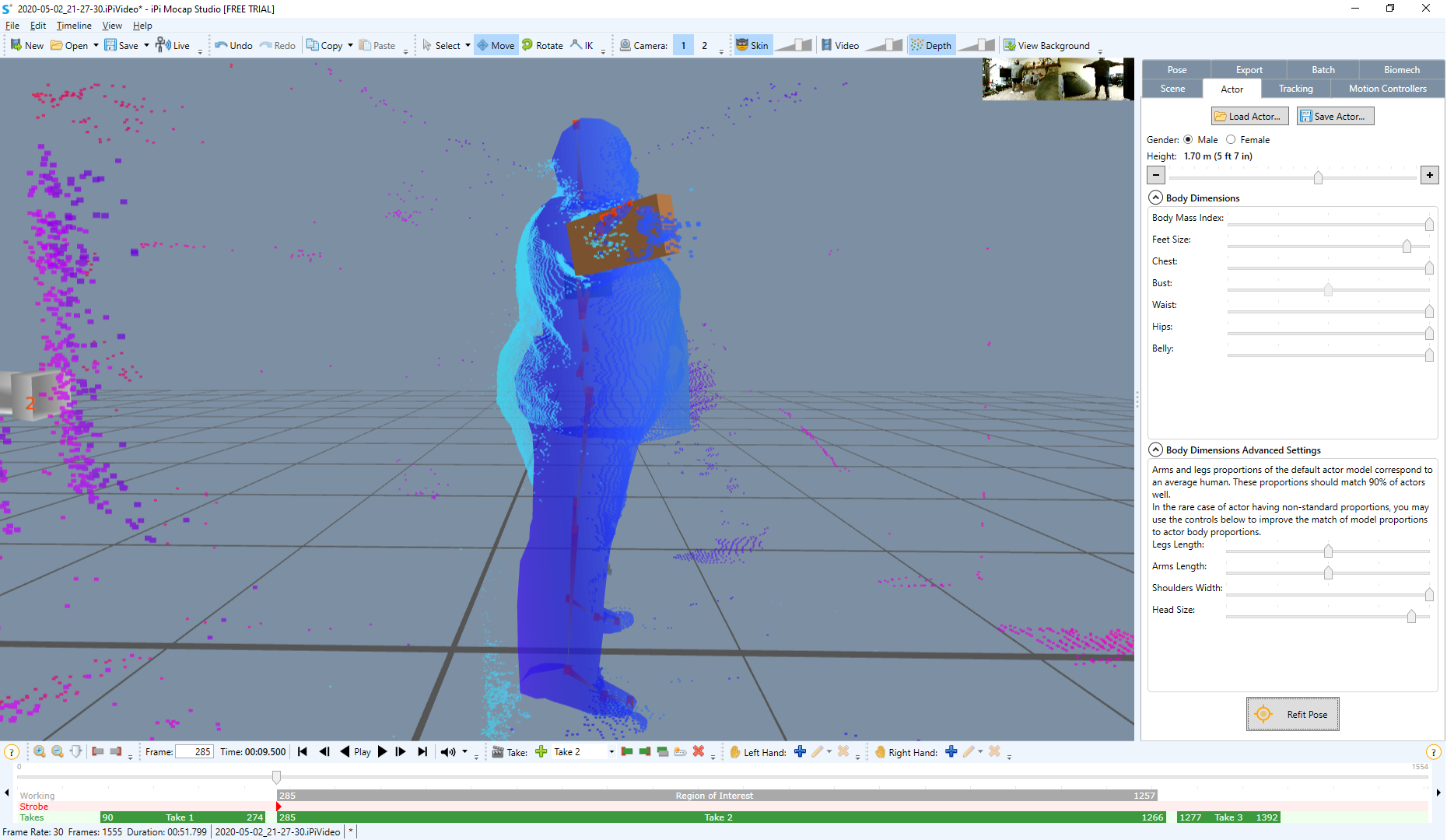

So I got the connection working but when i trace it thinks my spine is incorrect not sure hot to fix this. Event when I stop the tracking and adjust the hips and spine back to the general locations and continue tracking it puts this weird bend in my tracing. Ive tried to make the default match as close as possible. but theres still a few oddities. My current setup is 180 config. I'm wondering is the 2 90 degree setup would be better?

PostPosted: Mon May 04, 2020 11:45 pm
Posts: 203
Hello,
you can share your .iPiVideo + .iPiMotion in order we could give specific recommendations (please use support e-mail ipi@ipisoft.com for that).
Recommendations based on your screenshots.
* Make sure you use "Stiff lower spine" tracking option
* Slim clothes is preferable (the clothes should stick to body, otherwise tracking algorithm can be messed up)
* I think that decreasing legs length may help (see Actor tab, Body dimensions advanced settings)
* Try turning on / off "Fast tracking algorithm" option to see which one works better

PostPosted: Fri May 08, 2020 3:26 pm
