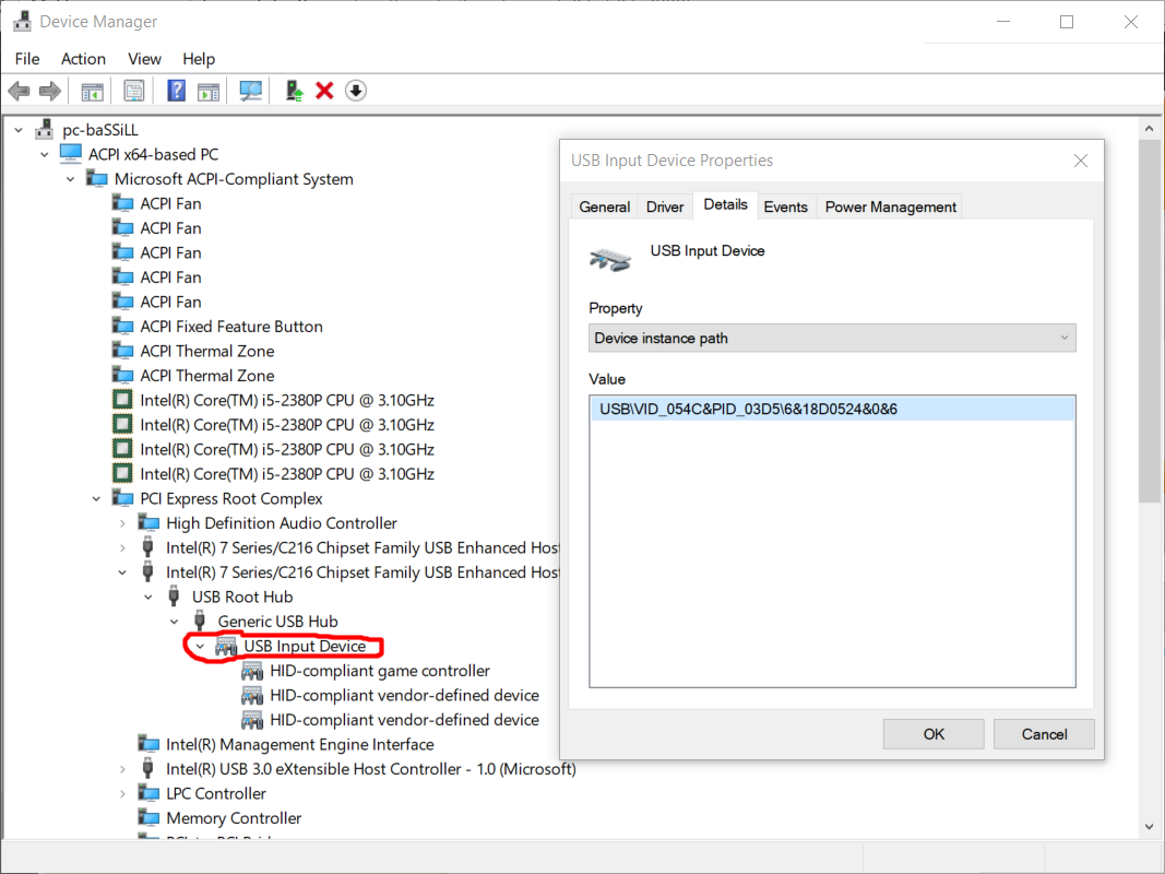

Please attach here a trace log from iPi Recorder after trying the pairing procedure. Press a button in the top-right corner of the main window to access the trace log.
Also, try to locate PS Move connected via USB in Windows Device Manager and get its Device Instance Path. I've attached a screenshot of how my PS Move looks like in the Device Manager (use View > Devices by Connection command to switch to this grouping of devices). It is an USB Input Device with 3 sub-devices.

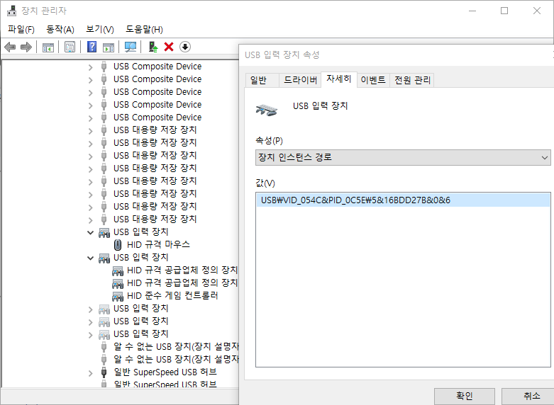

PostPosted: Fri Feb 02, 2018 10:26 am
Thanks for the data provided. It seems that your PS Move has different product ID for USB device.
We'll provide you a special build of iPi Recorder within a few days. It will look for this new product ID as well.
Good if it works for you. Otherwise we'll need to get the same model of PS Move and test it with iPi Recorder more thoroughly.
