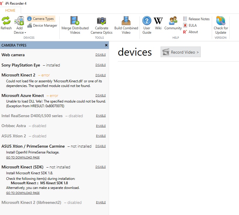

Hello, I'm getting an error message on the Ipi Recorder, on the camera types side panel.
The message reads:
Microsoft Kinect 2 - Error
Could not load file or assembly 'Microsoft.Kinect.dll' or one of its dependencies.
The specified module could not be found.
Microsoft Azure Kinect - Error
Unable to load DLL 'k4a': The specified module could not be found.
(Exception result HRESULT:0x8007007E)
I've just finished setting up a fresh install of Windows 10. I've tried reinstalling both the Kinect SDK and the Ipi Recorder. I've also tried installing the Kinect Runtime 2.2 as I read it being mentioned on another troubleshooting site. I thought I hadn't installed vc runtimes, so I used steam to install the complete pack of vc runtimes but it hasn't helped.
*The error message for "Microsoft Kinect 2" will go away if I uninstall the Kinect SDK. Instead it will have the normal message telling me to install the Kinect SDK, so it seems to be functioning well up to that point.
Any ideas why this is happening.

Just a quick guess - it may be something about permissions. Try running iPi Recorder as administrator.
To dig further into a missing dependency path, you may use the Dependencies utility. Open there iPiRecorder.Kinect2.dll and k4a.dll from the installation directory of iPi Recorder and look for any errors about dependencies.

Strange, the error message went away after I installed the Media Feature Pack from PC Settings> Apps> Optional Features> "Add a feature"
It works but now I've got to find out why my framerate is low.
It's interesting that when I change the video mode, the frame rate stays 30fps for a few seconds before it starts dropping down to 16 then to 8.
