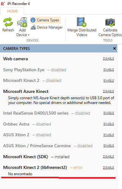

Good evening, I have a strange problem with ipi Recorder 4.
This happened to me a few hours ago and I don't know how to fix it, when I open ipi studio 4, my kineck doesn't appear, I take a look at the camera types tab, everything appears fine, but at the bottom it says Microsoft Kineck 2 (libfreenect2 ) - error
*not found*

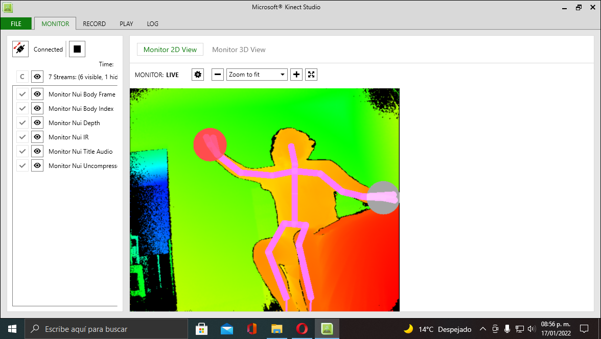

The strange thing is, my kineck does connect and works perfectly in the kineck studio, it gives the image, it tracks the skeleton, it gives depth, etc.
I already installed and uninstalled ipí recorder 4 twice but it keeps throwing me the same warning.
I have already updated and reinstalled my Nvidia drivers, but nothing.

File comment: here the kinect is in operation.

File comment: No encontrado mean not found.

If you only want to use a single Kinect 2 camera then use it in iPi Recorder via Microsoft Kinect SDK 2 not libfreenect. Click "Enable"next to "Microsoft Kinect 2" item (the second one in the list).
