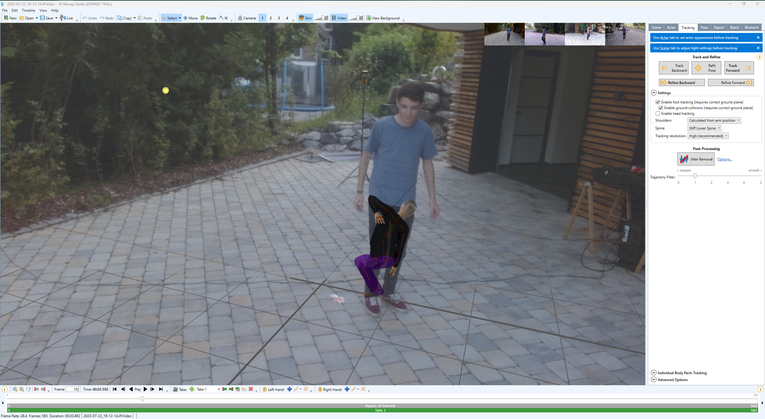

Hey everyone,

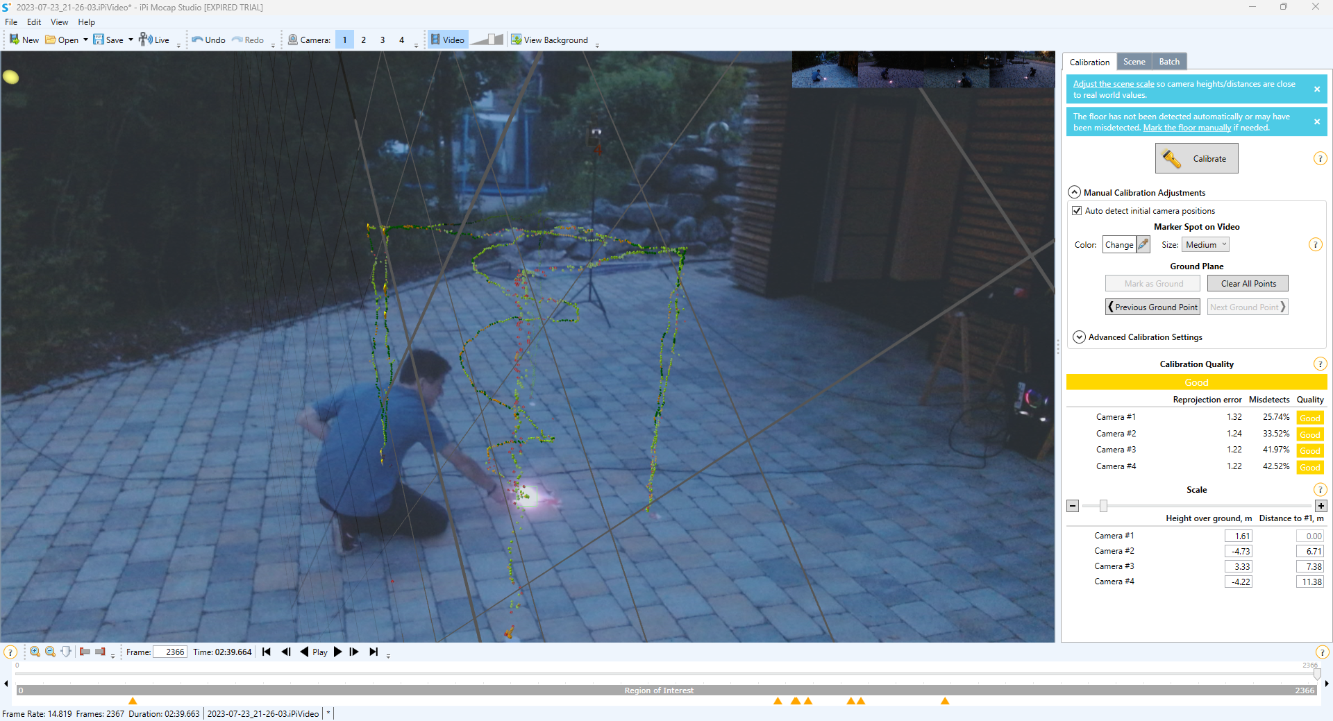

I'm currently working on a testshot for my Mocap Setup. I was finally able to get the calibration Project to work with using a PS-Move Controller.
I set up the ground points and it looks more or less right. But now the Actor in Mocap Studio doesn't match my Recordings and tracks very odly.
Does anyone know what to do?
I'm using 4 Logitech g22 Pro Stream on stands and one PS-Move Controller.
File comment: Issue
File comment: Calibration

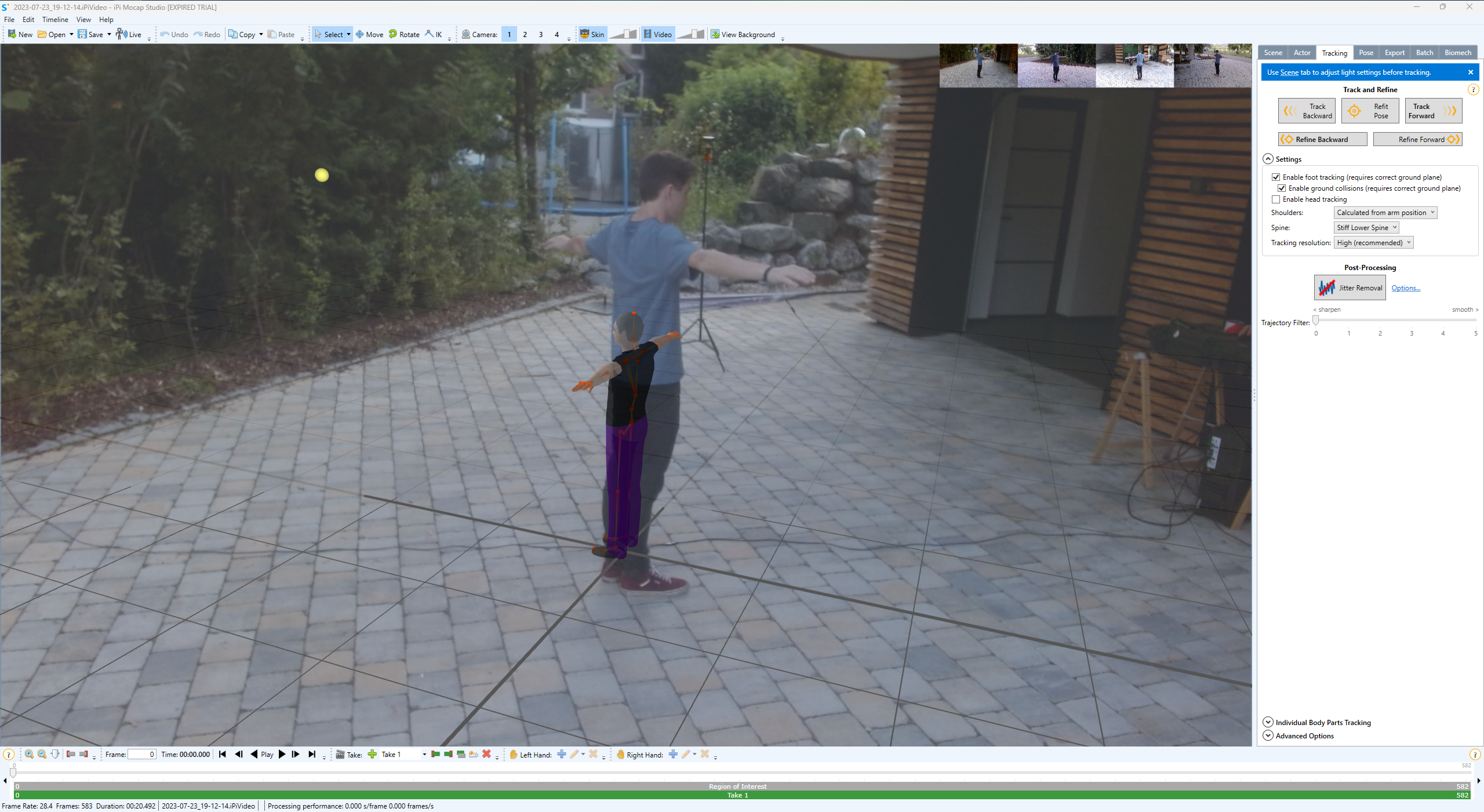

File comment: Actor doesn't match
PostPosted: Tue Sep 05, 2023 7:13 am
Posts: 466
Hello D3FX,
Thank you for sharing.
Did you set correct scene scale after calibration? It is very important. In other case scale of actor on video does not match scale of 3D character. For more information see Step 8 in User Guide.
Also, please do not forget to check that ground plane is correct (on your second screenshot ground plane is almost vertical which is obviously wrong).
