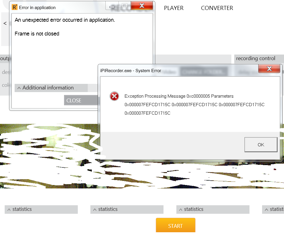

Trying to use the recorder with no success. It worked a day ago but now it simply give me errors and such. When i tried walking on screen it gives me this

[Thread: Name='', Id=1, IsBackground=False, IsThreadPoolThread=False]
System.InvalidOperationException: Frame is not closed
at iPiVideo.VideoWriter.EndVideo(Tail tail)
at iPiRecorder.Recorder.VideoRecorder.StopRecording()
at iPiRecorder.Recorder.ViewModel.RecorderViewModel.StopRecording()
at iPiRecorder.Recorder.ViewModel.RecorderViewModel.<>c__DisplayClass73.<OnRecorderHalt>b__72()
at System.Windows.Threading.ExceptionWrapper.InternalRealCall(Delegate callback, Object args, Int32 numArgs)
at MS.Internal.Threading.ExceptionFilterHelper.TryCatchWhen(Object source, Delegate method, Object args, Int32 numArgs, Delegate catchHandler)
That's the rest of the error. I'm on win 7 and it was working a few days ago. Any one ever have this issue? It does this after 3 seconds or so

Thanks for report.
I assume you are using PS Eyes, is that correct?
If Recorder does not crash completely, can you please attach a trace log taken after reproducing the error? To take a trace log, go to the tools menu in upper-right corner and press the SHOW TRACE button.

I've uninstalled then reinstalled the recorder later on that night and it works just fine now. There were also some changes made to my system specifically programs that interact with the microphones (scribblar) but if this problem comes up again i will be sure to post the trace log immediately.
PostPosted: Sat Jul 21, 2012 8:10 am
Fixed in Recorder 2.0.0.14.
