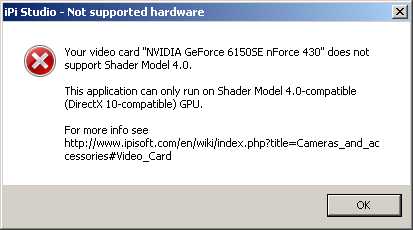

OK, then why am I getting this on my computer?

NVIDIA GeForce 6150SE nForce 430 is integrated graphics, which are not supported by iPi Studio. You should use descrete video card with DirectX 10 support. That's nothing about the iPi Studio version. Do you affirm that v1 worked on this computer?

Was working 3 weeks ago or so, with the current card. V2 wont run on this computer.
Could have DirectX 10 gotten corrupted?
