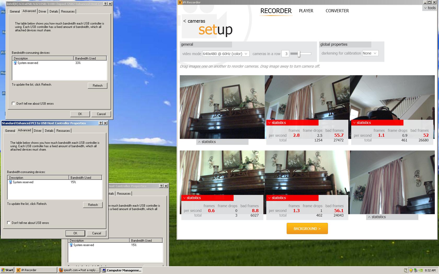

I can't really determine why I can't get 60fps on 6 cameras @640x480. I have a 128gb SSD that is exclusively for Ipisoft capturing. I have bought 2 different USB controllers, + the built in controllers. But can't get 60FPS.
I did a clean install of XP pro 32bit, I had 64bit on, but it seems Ipisoft 2.0 does not support 64bit xp
My system is a HP XW6600
2 5430 quad xeons
8GB ram (only 3.25gb with 32bit)
GTS450 1GB
320gb system drive Mechanical
128gb SSD
1 belkin usb controller
1 Generic USB controller, Both Belkin and the Generic seem to be running the same USB controller chip.
The system has 7 USB2 ports 2 front 5 back

So when I launch ipi recorder 2 at the setup stage, I can only achieve 60fps @640x480 on two cameras, the rest of the cameras are red, and have a very low frame rate like 0-3fps, and produce dropped frames, and Bad frames, Actually they make more Bad frames then dropped frames. The Bad frame rate is quite high, anywhere from 5- 50+fps
I can record at 640x480@30, and can get 60fps @ 320x240.
It seems there is some sort of band width issue with the USB controllers, that is why I bought the additional controller.

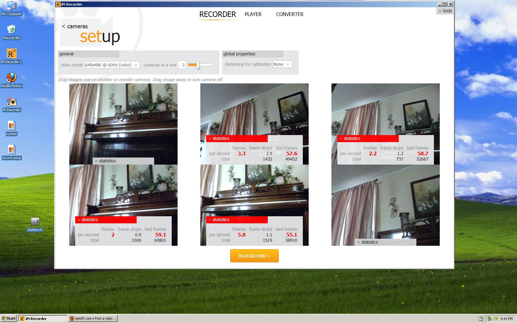

What are Bad frames? I can get 2 cameras to record 60fps @ 640x480, and the other 4 are recording 60fps, but they mostly bad frames (see picture). So it seems that my system can do the 640x480@ 60, Just not sure why 4 out of the 6 cameras are recording bad frames.
PostPosted: Sat Jun 23, 2012 2:39 am
Frame is considered bad when the camera signals it has a new frame, but does not supply (sufficient) data for it. Frame drops are detected when the camera does not signal a new frame for a reasonable time. Not near-zero values of any of these numbers usually mean there are USB bandwidth problems.
Try connect cameras one by one watching for statistics after each connected camera. If after connecting next camera you start getting bad statistics, reconnect this last camera to another USB port and watch again. And so on...

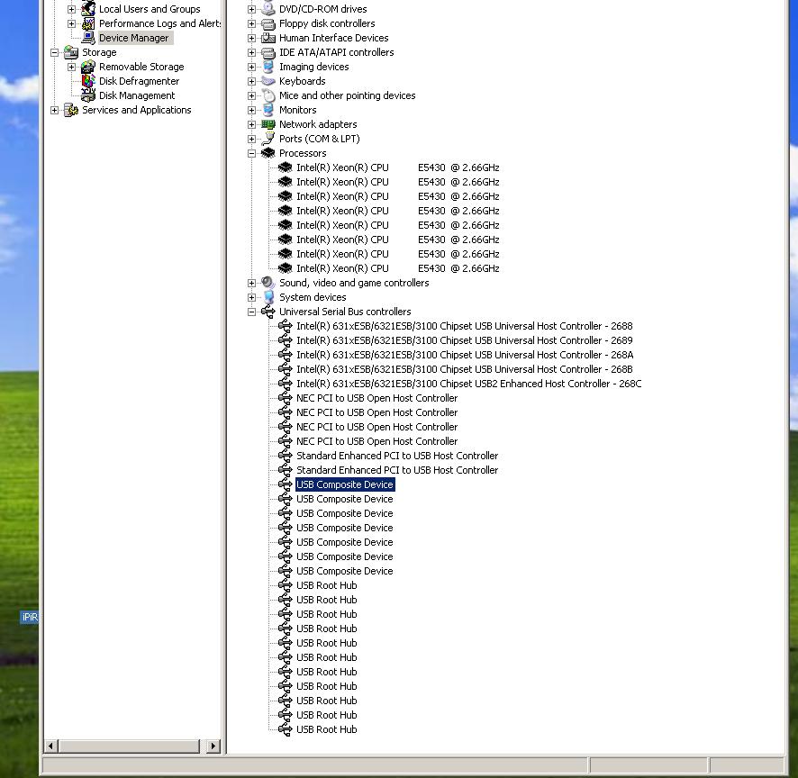

So after doing some tests It seems that the USb Bandwidth is the issue.
From what I can tell in my system, I have 3 controllers for USB 2, The Motherboard has 1 controller, and the 2 USB2 PCI cards I have added make 3 total.
I tried plugging in one camera at a time watching the USB bandwidth.
It seems that each camera uses slightly less then 6% of USB bandwidth.
The Built in controller starts up with 15% Used.
The other 2 controllers each start up 10% Used.
I was able to get 2 Of the cameras to be able to record 640x480 @60fps while plugged into the Front ports of my system. Adding theses 2 cameras makes the onboard Controller bandwidth go to 27%, If I add another camera, the system can not handle 640x480@60fps, and it produces mostly bad frames.
So I thought that I should be able to plug 2 cameras into each of the remaining controllers.
So I tried 1 camera in each controller first, And this works perfectly. Each controllers bandwidth goes up to about 15%, and I am able to record 4 cameras 640x480@ 60FPS.
However neither controller will allow me to plugin an additional camera, and maintain 60FPS @640x480
Which I thought was weird, because the resulting bandwidth on the additional pci USB cards would only be 21% .
So, for now I have 4 cameras 640x480@60FPS, I plan on buying a PCI Express USB3 card and seeing if it will allow me to plugin 2 cameras, and maintain 640x480 60FPS.
