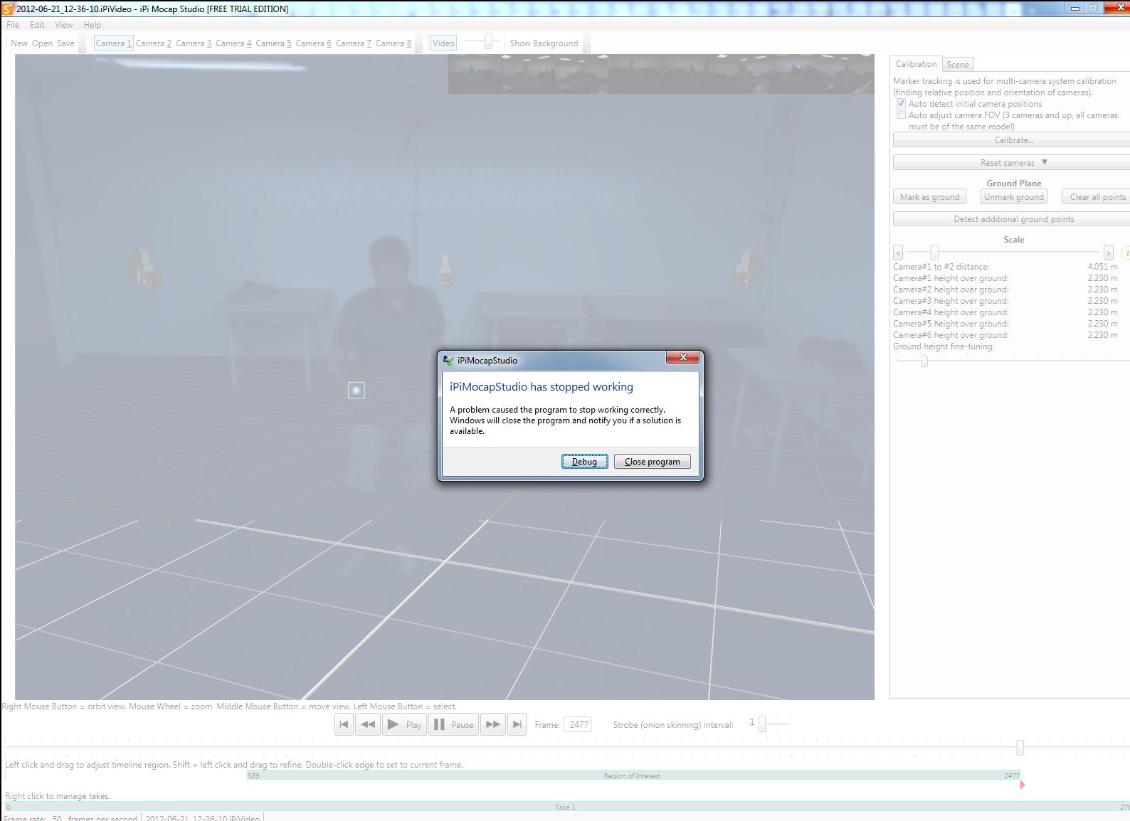

We have 8 eye-toy cameras working in 50 hz, 640x480, windows 7 professional, NVidia GTX 460, 16GB ram running iPi 2.0 trial version.
When 8 cameras recorded calibration video is imported into Ipi Studio 2 and calibration is started on a range of frames (previously manually adjusting 1st camera height to 2.23, without manually adjusting initial camera locations in 3D), iPi Studio 2 crashes every time with "ipiMocapStudio has stopped working" message at the end of processing given video range.
We have tried 2 different videos and several different video ranges, but application crashes every time.

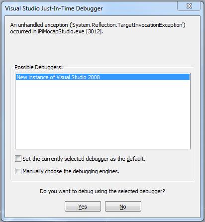

Debug button gives following info: An unhandled exception ('System.Reflection.TargetInvocationException' occured in iPiMocapStudio.exe [3012]).

Currently, iPi Mocap Studio supports only up to 6 cameras, not 8. Most probably larger number of cameras in record causes the error. However, I agree that the program should limit its capabilities in a more graceful manner than just crash.
Please try with 6 cams and writer if the error still appears.
