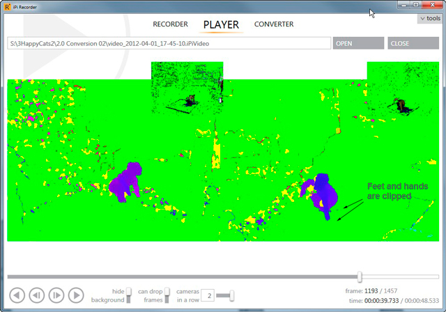

Still playing around the the 'Three Happy Cats' data in iPi DMC 2.0. When tracking, it seemed like iPi Studio was having a lot of trouble figuring out where the feet were so I took a closer look at the data in Player. Here's what I found:
It looks like her feet are being completely clipped by the ground plane. When she touches the floor, her hand also becomes clipped from the volume data. I was wondering if you've seen anything like this? Could it be that the calibration off because she is standing on a foam mat that is about 1.5 cm thick?

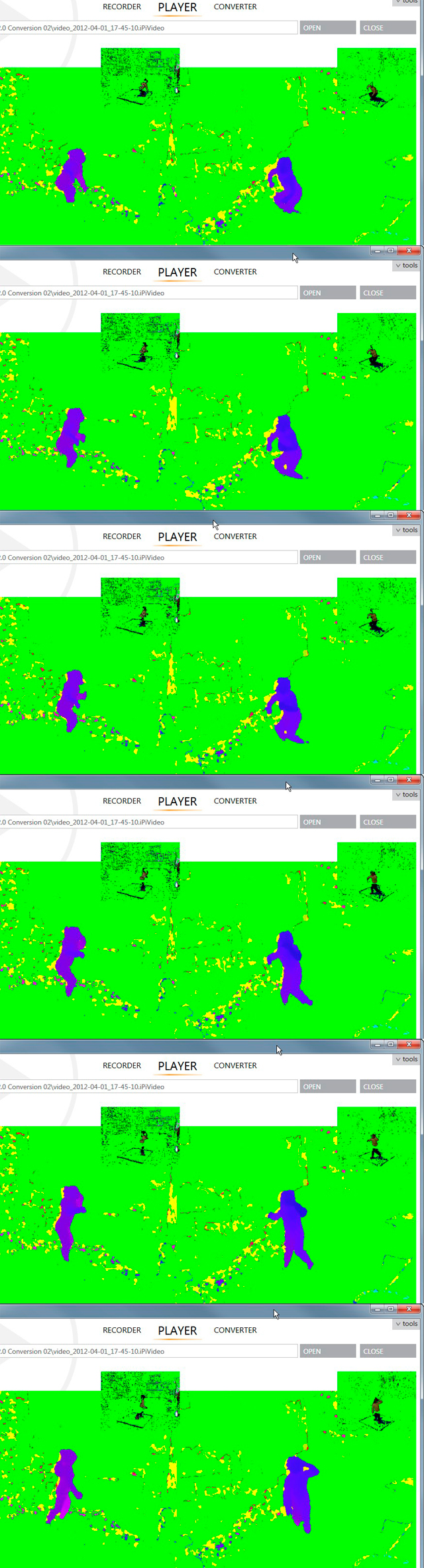

Here are a few more frames to further illustrate the error:
I haven't compared this with results from iPi DMC 1.0 yet. From what I recall, it's probably the same though.

Most probably this is the result of background subtraction. With such camera orientation any slim body parts like feet and hands touching the floor have a very small difference in depth with the background (the floor itself). So background subtraction algorithm assumes this is just some noise and replaces it with the background. We also have noticed such unwanted behavior with adult actors when depth sensor is placed considerably high (at 1.5m) and looks down at considerable angle.
This is indeed a problem which has become more obvious now. We need to figure out some improvements to background subtraction algorithm that will eliminate this issue.
However, I can assure you that this is not a novelty of v2 and the tracking quality does not suffer compared to v1. In v1, essentially the same algorithm was used by the tracker under the hood. You just did not see its results.
