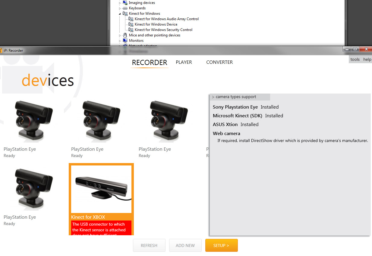

with new version (ver. 2.1.1.18) of iPi Recorder and new Kinect SDK (1.6) my Kinect for XBOX stopped working. Since I updated iPi recorder my Kinect just disapeared from Devices window in iPi recorder. After reconnecting it pop-ups the warning "The USB connector to which the Kinect sensor is attached does not have sufficient bandwith. Or two Kinects are using one and the same USB.".
Just announcing my Kinect is connected to regular single USB slot and I also tried switching and reconnecting it and restarting.
Thanks for any help.
File comment: Error message in iPi Recorder.

PostPosted: Tue Nov 27, 2012 3:05 am
Are some of these PS Eye cameras attached to the same USB controller as the Kinect? Have you tried to unplug them?

PostPosted: Tue Nov 27, 2012 8:14 am
Please make a screenshot of Device Manager, in Devices By Connection view, expanded to show the devices for Kinect:
  • Microsoft Kinect Camera
  • Microsoft Kinect Audio Array Control
  • Microsoft Kinect Security Control

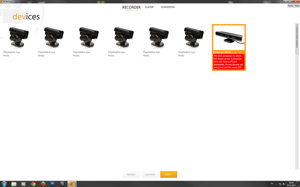

PostPosted: Tue Nov 27, 2012 9:38 am
Joined: Wed Nov 21, 2012 2:45 am
Posts: 17
FYI :)
PostPosted: Tue Nov 27, 2012 9:42 am
Posts: 17
now I realised where was the problem
Kinect camera was under PrimeSense, so I removed all primsense OpenNI and nite drivers and now everything works fine
