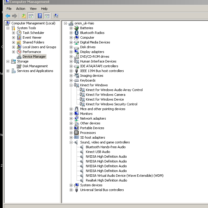

File comment: Kinect in Device manager

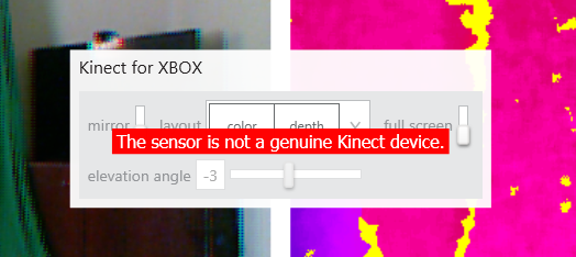

File comment: not genuine error image

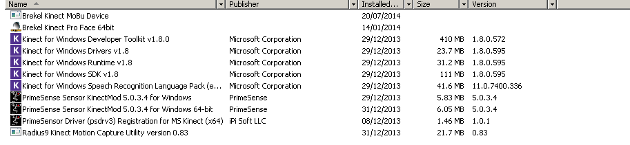

File comment: installed Kinect related programs

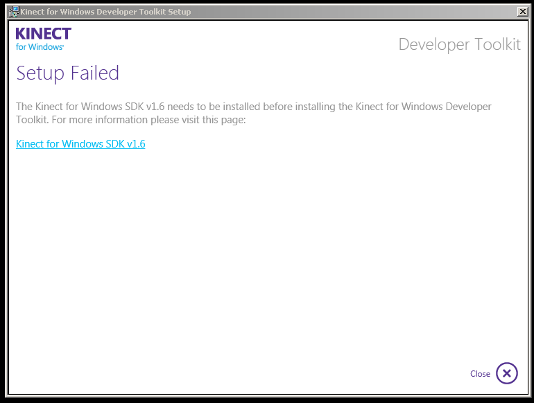

File comment: dev kit wont install after SDK install completes
dev kit wont install after SDK install completes.PNG [ 23.99 KiB | Viewed 32040 times ]
PostPosted: Tue Mar 31, 2015 8:36 am
I see that you have PrimeSense drivers for Kinect installed as well. It is very likely that there's a conflict between Kinect SDK drivers and those ones. Try uninstalling one of them.
Regarding installing the developer kit.
List of programs shows that you already have Kinect SDK and Kinect Developer Kit v1.8. And what fails to install is Kinect Developer Kit v1.6 - the wrong version. You should download v1.8 if you want to repair installation.
In any case, I don't recommend you to fall back to an older version of Kinect SDK.
