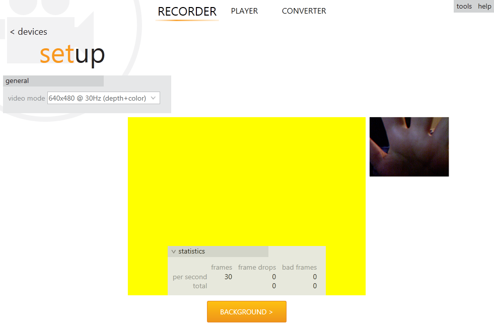

I've been trying to test out the dual kinect setup, but so far I have been unable to get the cameras to show up right in iPiRecorder.
With just one camera, the depth screen is a solid yellow, and while the normal camera will work at first, it will eventually freeze. Once it freezes, it refuses to even show that much upon reopening the program - it says that the sensor is in use by another application. Even unplugging and replugging in the sensor won't make this message go away - I have to plug it into a different USB to get it back to "normal."

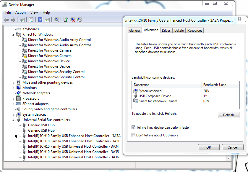

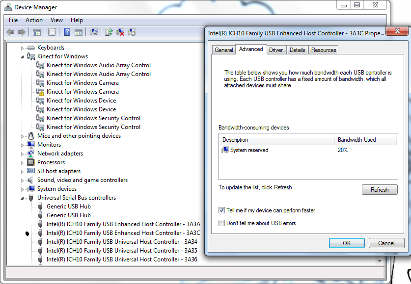

With two, both have the yellow screen problem, with only one normal camera showing up (the other being a black screen). Eventually, the same thing happens as detailed above. Additionally, it will sometimes give me a bandwidth error when trying to connect both at once, despite the fact that I think it shouldn't be a problem. (And, even if it is, I'm confused as to why it won't even work with just one.)
The second "Kinect for Windows Camera" driver has also failed to install correctly.

Did you install Kinect for Windows SDK, or Kinect for Windows Runtime? If it was during installation of iPi Recorder, that should be SDK. Runtime does not support Kinect for XBOX properly.
When you are waving a hand near to infrared sensor (as I see on the screenshot), it may be yellow because of too close object.
Try to select depth-only video mode in iPi Recorder. Does any depth data show up?

The hand in the picture was just me trying to protect my identity - it shows a yellow screen no matter what.
