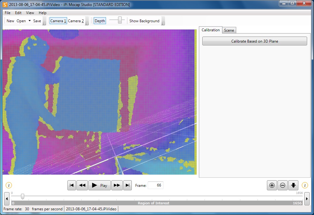

Hi there, I have a 2x xbox Kinect setup with angle between 90- 180 degrees.
Upon doing a calibration, I dont have any button visible to say "This is not a 90degrees or less calibration, it is a 90-180 degrees one" The only button visible says "Calibrate based on 3d plane" Theres nothing else on the calibration panel just this one button.
I have the latest version of studio and the docs included indicate it should still be there.
Please advise, thanks!
~AaronC
Edit: Yes these radio buttons, I don't have them in the latest version of Studio?

So I uninstalled studio and recorder, accidentally installed an older version, and after choosing calibration as opposed to action when opening a new clip, I notice that the old version then gave a window asking if you want <90 or >90 degrees.
I uninstalled those and installed the very latest again, and there was no second window asking what sort of calibration I wanted, and this is the calibration panel.
This is such a pain, I have work to deliver. Whats going on?

The current version auto-detects Kinects positions, so manual setting radio-button was removed as obsolete.
Usually incorrect detection of depth sensors positions is caused by little movement of the board during calibration. You should move the calibration board near and far from each of the sensors, and to the left and to the right (not turn, but move) at least in a half meter range. In all movements, watch for the board to be fully visible to both sensors. This should help.

Thanks, that did work, I got a clean calibration.
Its probably a good idea to update the wiki and documentation to reflect the interface/workflow changes as I had no idea if it was me, the program, my computer or where to start diagnosing this as the help files weren't matching what I was seeing.
