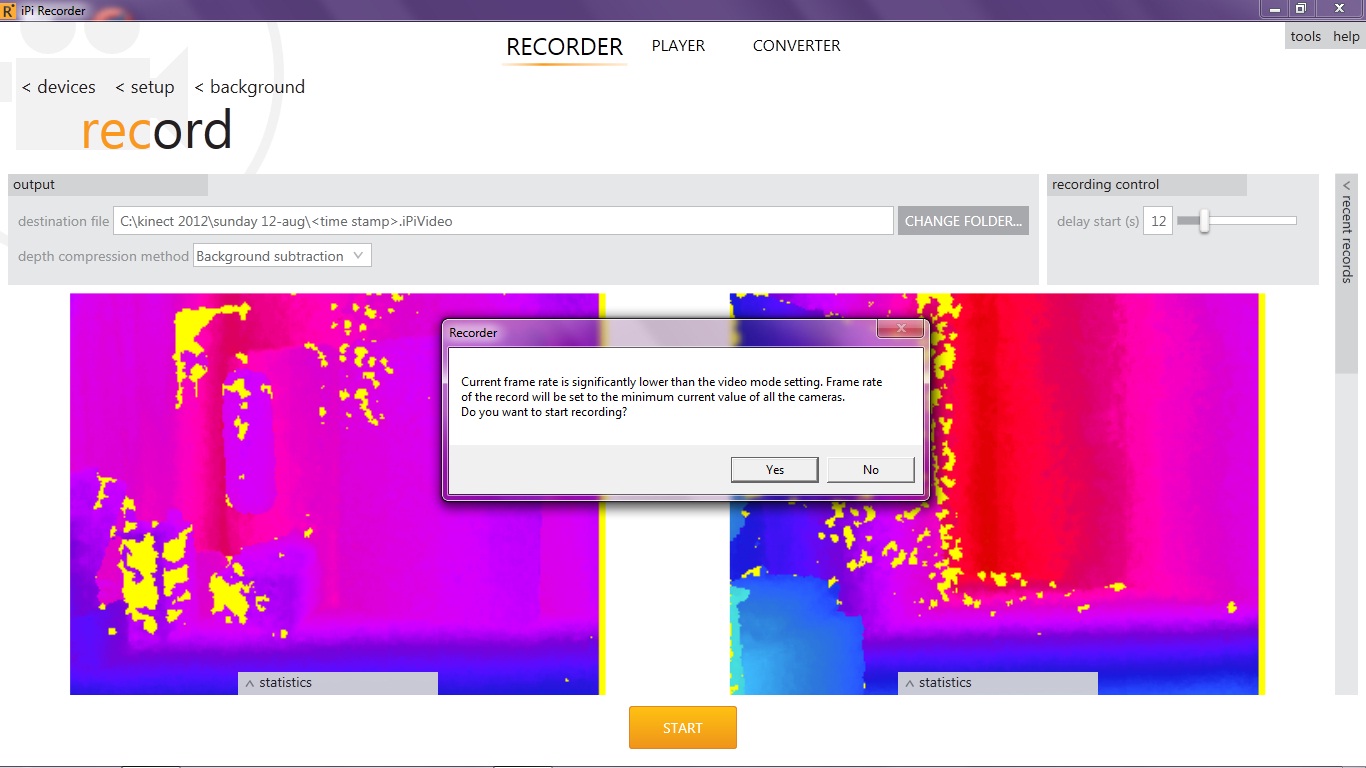

I am using a laptop with its own web cam. I have two kinects, both set to depth only. When I am ready to record it shows this nag screen. Why? Is it a problem? How doo I avoid getting this pop up?

This means that according to statistics the real frame rate of one or more cameras is lower than selected video mode's frame rate by >= 1 fps. This just signals you have USB bandwidth problems (maybe temporary), and it's not a good time to start recording.
Open statistics panels for cameras and watch when frame rate gets to expected value of 30 fps. If it does not after a dozen seconds, then you should try to do some corrections to your setup, e.g. use other USB port, or disconnect other data consuming USB devices.
If you decide to start recording in spite of low frame rate, than the real frame rate value from statistics will be saved to video file as its frame rate.
