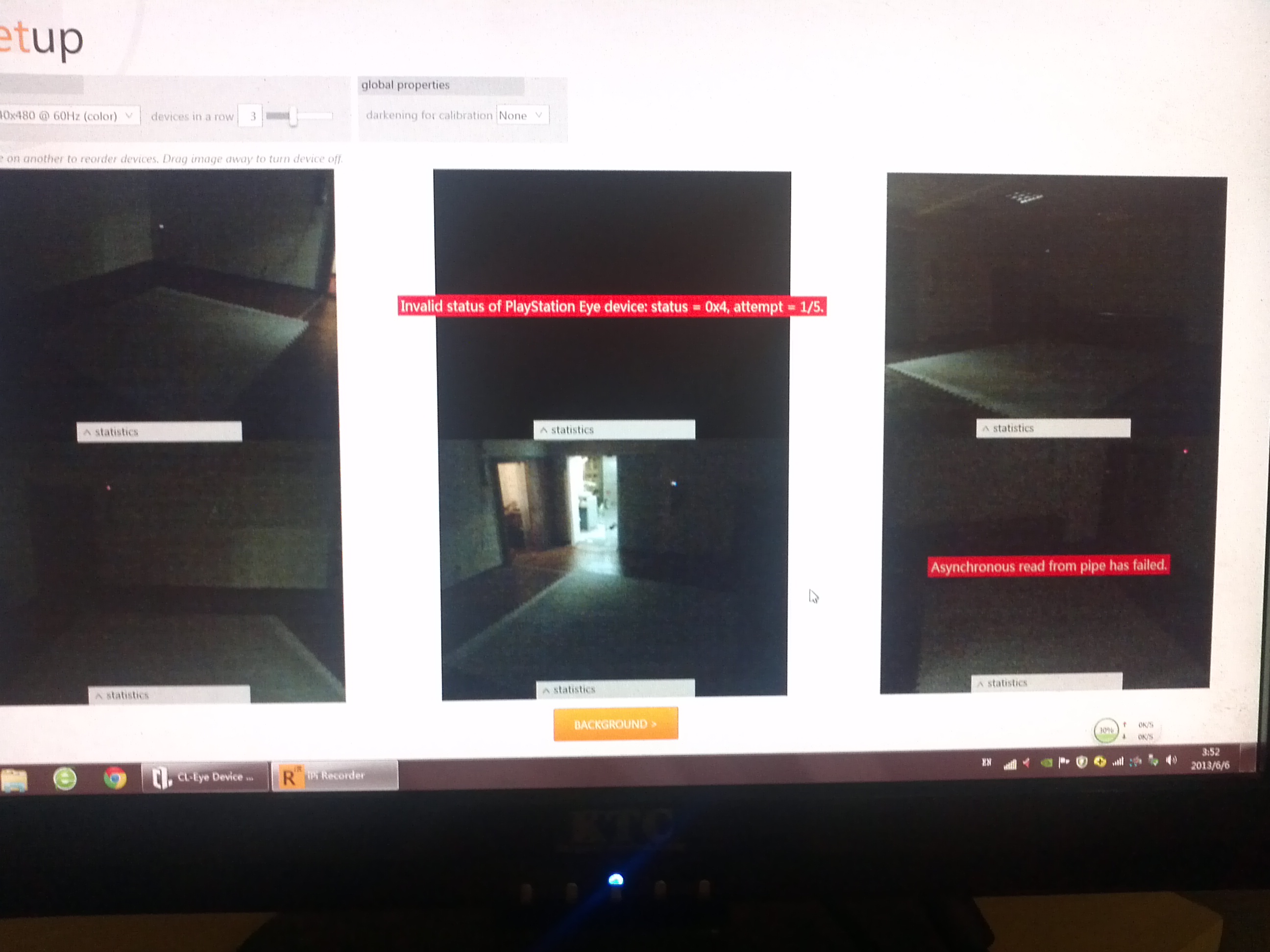

iPi Recorder 2, I used 6 EYE, only to realize 5, Section 6 total mistake, but the old version can,
I believe that the old version can, but I do not want to use the old version

From your screenshot, I see that you also have CL Eye drivers for PS Eye installed. They may conflict with drivers used by iPi Recorder to work with PS Eye cameras. Please uninstall CL Eye drivers and, if necessary, reinstall WinUSB PS Eye drivers bundled with iPi Recorder installer.

I go back to the Pi Recorder 1.8, can indeed
I will use your method to try again
Thank you
