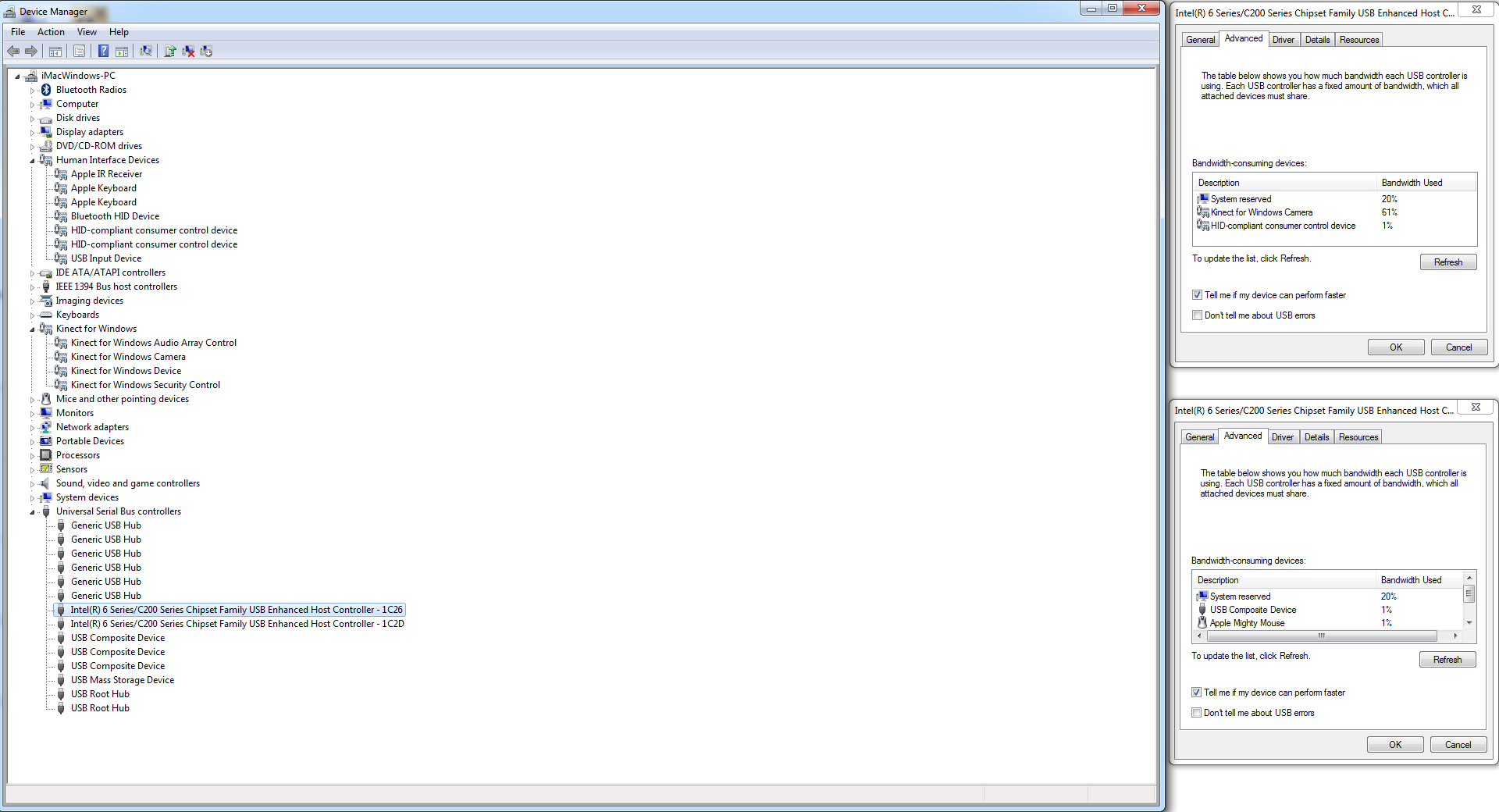

First, let's know what are those controllers - please take a screenshot of "USB controllers" node in Device Manager. You can open Device Manager right from iPi Recorder by clicking "tools > device manager" at the top-right.

Exactly. Cables I bought work on different machine with same kinects, but they give 'black screen' on my machine. I attached files you asked for. Unfortunately I don't have USB wire/hub with external power supply that you mentioned.

PostPosted: Thu Dec 19, 2013 5:57 am
Thank you.
Nothing interesting in the log.
Controllers are USB 2.0 built into the Intel chipset, the same I have on my PC.
OK. Let's continue troubleshooting...

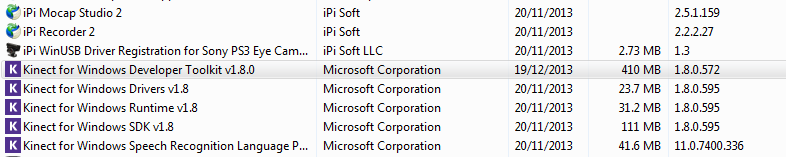

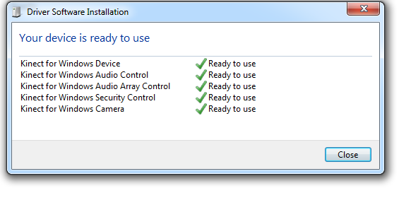

PostPosted: Thu Dec 19, 2013 8:36 am
Joined: Mon Dec 16, 2013 6:07 am
Posts: 19
I did uninstall all items with word 'Kinect' from control Panel. Then restarted iMac. Installed SDK and then Developer Kit (both from links you gave me - thank you for that). Then I plugged Kinect and some drivers were installed (window.png). When I opened iPi Recorder it worked as it worked before. Direct Kinect to iMac connection works, but extension wire gives black screen.
In addition I tested PS Eye (I have access to only one of these) and it works with extension cable.
