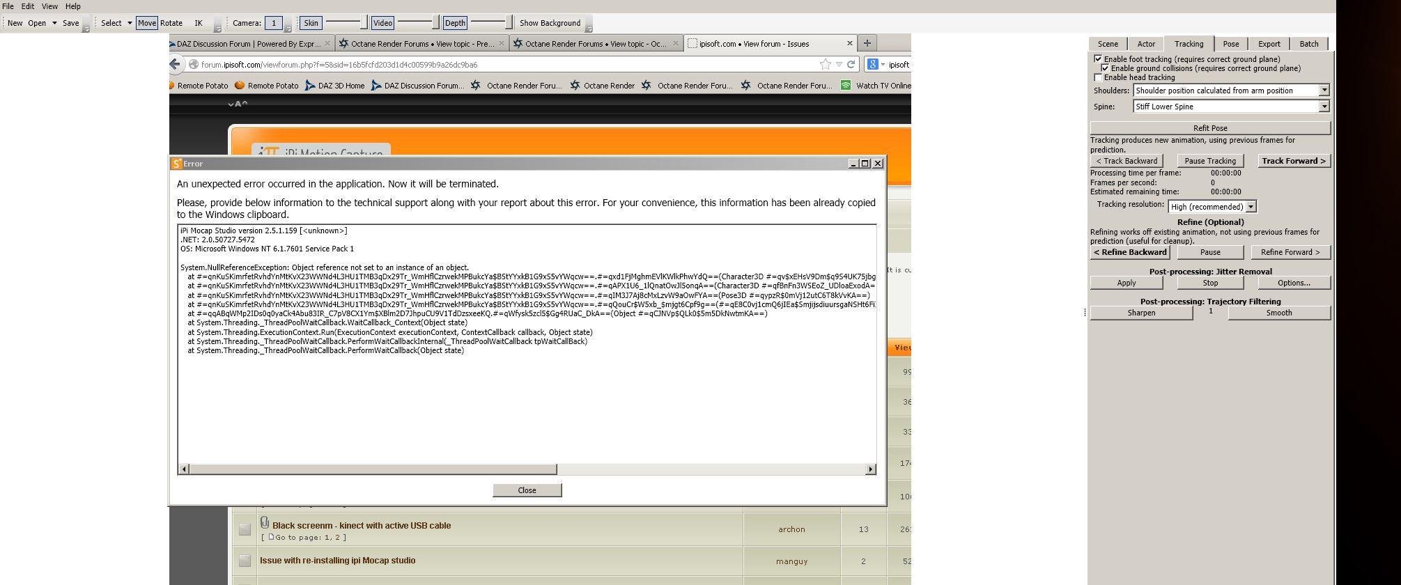

Hi all :)
I only recently got IpiSoft2 but had this while checking/selecting various view options!
Any ideas please?, Thank you :D
iPi Mocap Studio version 2.5.1.159 [<unknown>]
.NET: 2.0.50727.5472
OS: Microsoft Windows NT 6.1.7601 Service Pack 1
System.NullReferenceException: Object reference not set to an instance of an object.
at #=qnKuSKimrfetRvhdYnMtKvX23WWNd4L3HU1TMB3qDx29Tr_WmHflCzrwekMPBukcYa$BStYYxkB1G9xS5vYWqcw==.#=qxd1FjMghmEVlKWlkPhwYdQ==(Character3D #=qv$xEHsV9Dm$q9S4UK75jbg==, Pose3D #=qIivYLtpwKgoWMXWPsVrF$Q==, Nullable`1[] #=qu_Tw6qqGrrnQIIYkbSBXKA==)
at #=qnKuSKimrfetRvhdYnMtKvX23WWNd4L3HU1TMB3qDx29Tr_WmHflCzrwekMPBukcYa$BStYYxkB1G9xS5vYWqcw==.#=qAPX1U6_1lQnatOwJl5onqA==(Character3D #=qfBnFn3WSEoZ_UDloaExodA==, Pose3D #=qBrgHYNCML3JPkVel6PU8ng==, Nullable`1[] #=qOKlfcOX$ZcONQyapzteRVg==, Nullable`1[] #=qYBnFde4okKp8w9FPoCfbaQN4JRdG4zoCkIW23Vo9Mcg=)
at #=qnKuSKimrfetRvhdYnMtKvX23WWNd4L3HU1TMB3qDx29Tr_WmHflCzrwekMPBukcYa$BStYYxkB1G9xS5vYWqcw==.#=qIM3J7Aj8cMxLzvW9aOwFYA==(Pose3D #=qypzR$0mVj12utC6T8kVvKA==)
at #=qnKuSKimrfetRvhdYnMtKvX23WWNd4L3HU1TMB3qDx29Tr_WmHflCzrwekMPBukcYa$BStYYxkB1G9xS5vYWqcw==.#=qQouCr$W5xb_$mjgt6Cpf9g==(#=qE8C0vj1cmQ6jIEa$SmjijsdiuursgaNSHt6FiILTZrWLm$iHw9Uj2Wv46r_PY9R2[] #=qF4vSrQX4JZlHVynzCMidxA==, Double[] #=qW2_hgos2CO9UWwuDF6Ft8A==)
at #=qqABqWMp2IDs0q0yaCk4Abu83IR_C7pV8CX1Ym$XBlm2D7JhpuCU9V1TdDzsxeeKQ.#=qWfysk5zcl5$Gg4RUaC_DkA==(Object #=qCJNVp$QLk0$5m5DkNwtmKA==)
at System.Threading._ThreadPoolWaitCallback.WaitCallback_Context(Object state)
at System.Threading.ExecutionContext.Run(ExecutionContext executionContext, ContextCallback callback, Object state)
at System.Threading._ThreadPoolWaitCallback.PerformWaitCallbackInternal(_ThreadPoolWaitCallback tpWaitCallBack)
at System.Threading._ThreadPoolWaitCallback.PerformWaitCallback(Object state)
File comment: screen capture
PostPosted: Mon Jan 27, 2014 2:03 pm
Hello
Can you please describe in more detail, what was happening in the program at that moment?
What option have you checked/unchecked immediately before the crash?
Was there any activity in process like playing back, or tracking?
PostPosted: Thu Jan 30, 2014 3:44 am
After debugging, we've found that this error comes up as result of combining jitter removal and "Pose Mismatch" view. It will be fixed in the next update of Mocap Studio.

PostPosted: Wed Feb 19, 2014 9:10 am
Fixed in iPi Mocap Studio 2.6.0.161.
