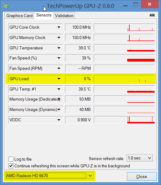

Thanks for the screenshots. Though I do not understand text on some of them (Korean?) :)
Please check the load of individual GPUs when tracking with both GPUs selected. This info may be present in NVIDIA control panel. If not, use GPU-Z utility:
http://www.techpowerup.com/gpuz/
Run it and go to the 'Sensors' tab. Look for 'GPU load' value. Use combobox at the bottom to switch between GPUs.
File comment: Monitoring GPU load in GPU-Z
I have attached a screen shot. From GPU-z.
And i disable intel Gpu. Because i thought that Intel GPU is interference.
But, that was not.
