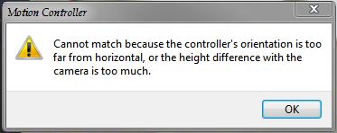

On several runs now, the Move I use on the right hand (after both calibrated successfully) won't align with the camera chosen at all in T-Pose, no issues before update.
Both controllers won't follow proper trajectory of the video even after getting them to align in another portion of the ROI, they will flip completely backwards to what they
should be on many occasions while tracking, and just not following video as they should, no issues doing this before update either.
When in T-Pose they should align easily to the camera they are pointed at and I can't seem to get right hand one to do that now at all.
Can someone look into this issue, or explain why this could be occuring now, I shouldn't get this warning when aligning in T-Pose for right hand controller, left hand
controller aligns, both do strange things when tracking video.
I did do the latest update also and same thing happening.
Thanks

The warning means that in the frame where you aim at camera PS Move is not in horizontal plane. Thus its azimuthal direction cannot be determined for sure.
If you choose to aim at one of the high cameras (above 2m), then select another one at a regular height (1.5m or so).
You can share one of the problem videos so we can analyze it in more detail.
