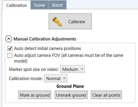

Manual Calibration Adjustments are on the Calibration tab. See the screenshot in attachment. You can also see there buttons for working with ground points in case the ground was not detected correctly by the program after the calibration.
The light should be seen in as many cameras as possible. Having only 4 cameras, it's quite easy to make it visible to all cameras at once with a little practice. One technique that some users employ for that purpose is to attach the light to an end of the stick to minimize the occlusion by a person's body.
There's no way to limit camera movement to vertical axis. I do not recommend to do any manual editing of camera positions in your case. Automatic detection of initial camera positions (turned on by default, you can also see this option on the screenshot) works very reliably for 4 cameras.

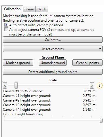

But I think I don't have the same version as yours because I don't have the mentionned options (see pic)

That is Version 2 of iPi Studio, but the calibration process is the same.... with 4 cameras in that version it is a bit more touchy to get good calibration, and a lot slower in processing it, but it will calibrate fairly well once you get the "trick" down.

Yes, indeed. Your screenshot is from version 2. You should have mentioned that before as we naturally assume the latest version by default.
It does not have the option for marker size. However, the calibration for 4 cameras is very reliable as well given a proper calibration video. You can see a sample of calibration video in our wiki:
