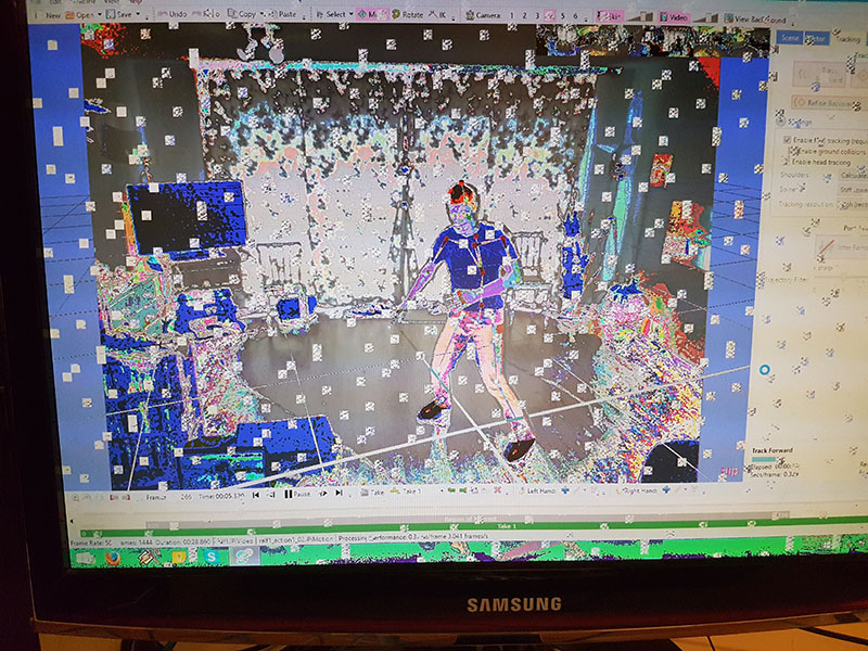

Hi. Used ipi soft for the first time. it was all looking good. I even managed to finish my first mocap. But the size of the character wasnt matching the actors size. Since then i tried to adjust 3d character to get better tracking and so final resaults. Ever since then the software crashes when i come to the tracking part. After a few seconds of tracking it freezes, then pc shuts down. Crash.
Here's a screenshot lookin really weird:
Pls help! Why is it crashing?

Looks like a video driver issue. Do you have the latest version of NVIDIA drivers installed?
