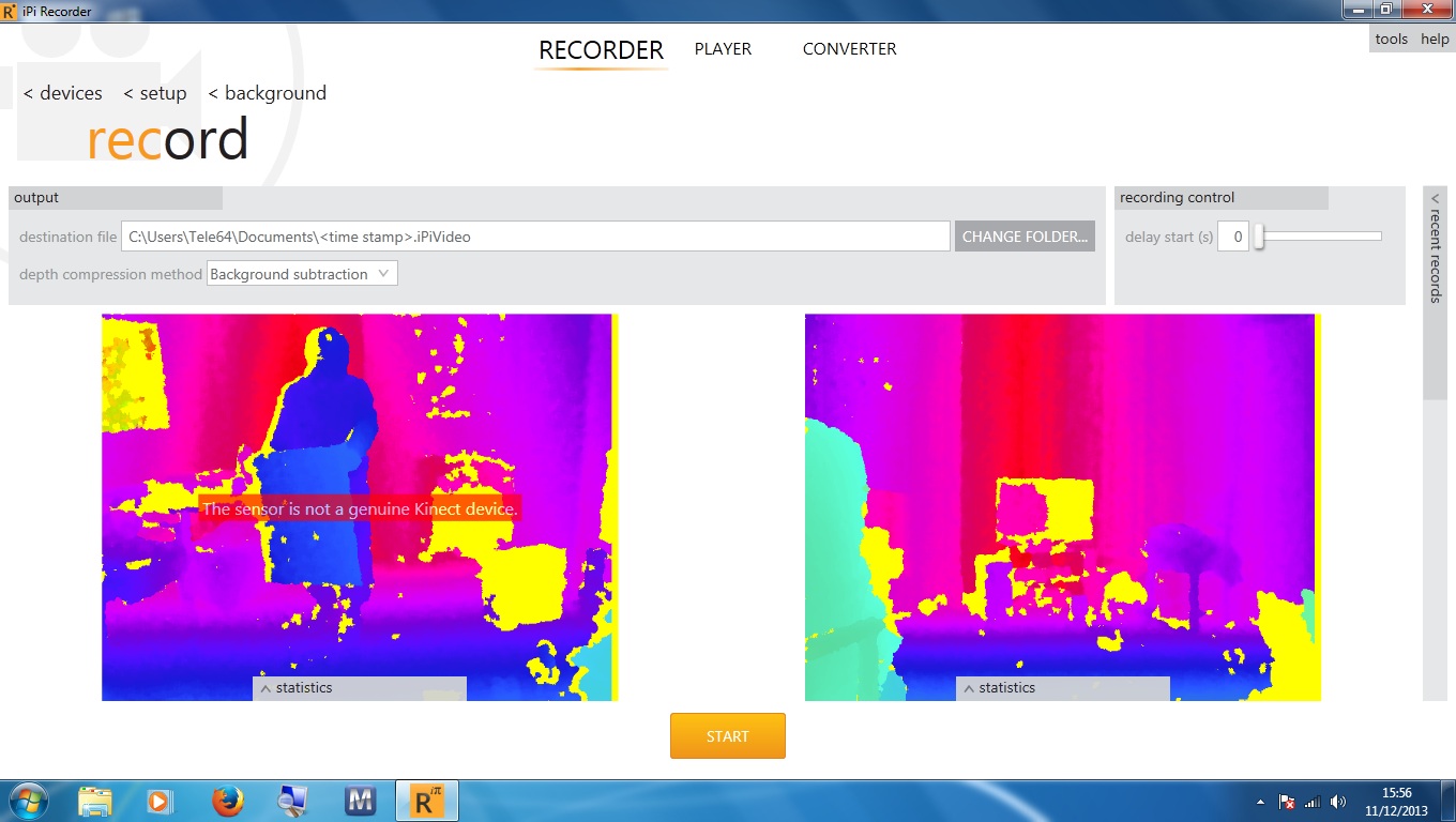

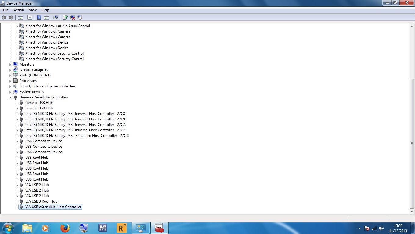

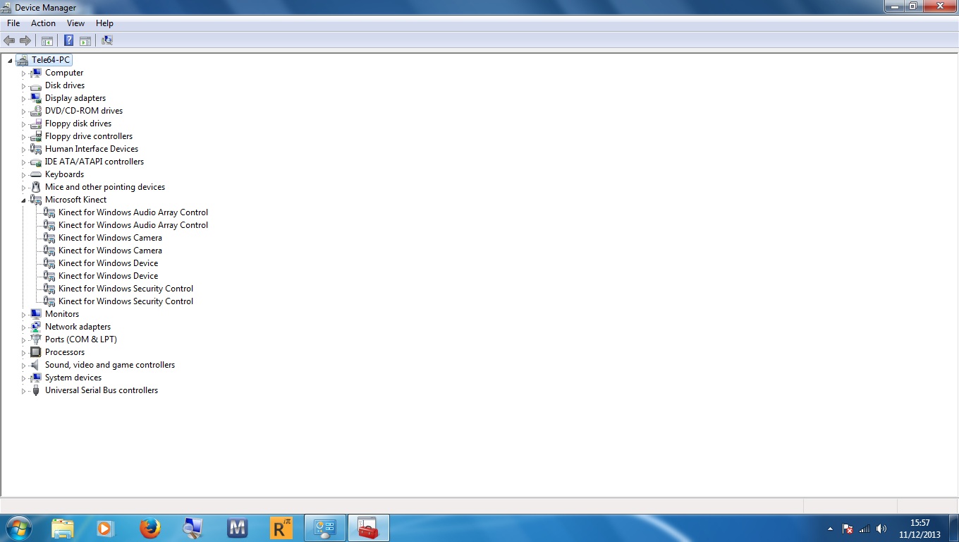

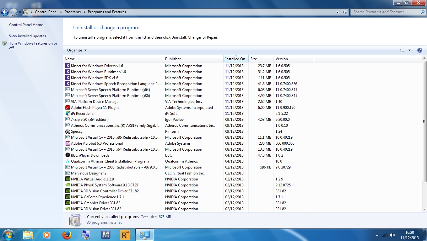

I have looked at the other topic which offered a solution, the suggestion was to download kinect for windows sdk 1.6, it did not work.
I have tried unistalling the drivers several times, still no satisfaction.
I have two xbox kinects.
I have fitted a usb 3.0 on my motherboard.
Originally i try the new version of recorder with KFW 1.8, had the same problem.
I hope there is a solution.
Cheers

PostPosted: Wed Dec 11, 2013 10:34 am
Have you tried PrimeSense drivers for Kinect? You can download the 64-bit installer here.
Do both Kinects show the same error or only one of them?
Does a single connected Kinect work?
Is the issue related to plugging a Kinect in a specific USB port(s)?

So the PrimeSense drivers for Kinect will work on the ver. 2.2.2.27 recorder? I shall try the download.
