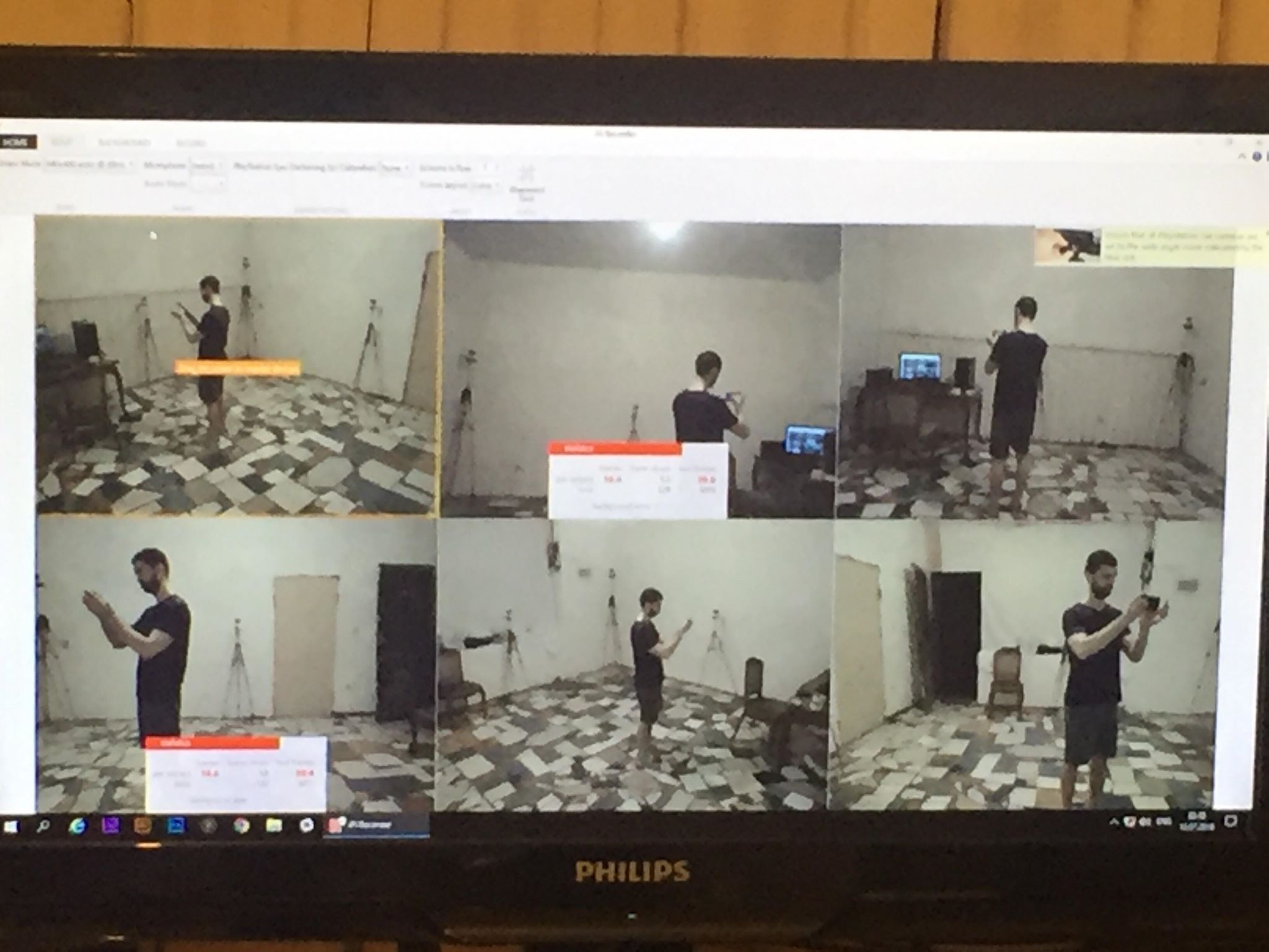

Hey guys,
I'm having some endless troubles with 6 PS eye cams... Problems are mostly Low FPS related and I'm trying to find out the reason of it.
2 or 3 cameras most of the time perform at 13-20 fps. The best result I've got was 60 fps on 4 out of 6 cams, but even that stat was a temporary one,
because it has changed after a couple of minutes (and I don't understand depending on what circumstances). I could make one of this low fps cams to work on 60fps
after moving up and down the camera with a tripod, just randomly... But it didn't work for the rest... I have attached the photo of the screen where u can see my space and camera positions... I know that the floor should be uniform and one colored for better results and that I need the ambient lighting (now I have the luminescent lighting from the single centered lamp), but I'm not sure that this is the reason of my low fps results, because there are videos where people capture the motion in offices with lots of objects in the background and stuff... I wanted to test whether the 40 fps setting will change the result or not, but actually I could not find this option anywhere in ipi Recorder.
My configuration is:
- 6 PS 3 Eyes
- I've got an old PC, but with really good Intel i7 Quadcore, 16GB memory...
- Windows 10, 64 bit
- 3 separate USB controllers, 2 of which are 2.0 and 1 is 3.0 with relevant extension cables for each...
- space is 5.5 meters by 6 meters
Please help guys, as I'm really close to depression...
Thanks
File comment: Here is the image of my situation.
37117237_10217106561714987_2450375951578562560_n.jpg [ 215.78 KiB | Viewed 51725 times ]

Screen shot is very blurry, can't read the fps, but I take your word it isn't good.
Just an inquiry, when you say "relevant extension cables", are they active repeater cables?
Like this: https://www.amazon.com/gp/product/B002V ... softcom-20 ...
Or standard passive USB extensions? over 6 ft, passive cables won't work right.
(Quote from iPi information just in case you are doing this: If combining active and passive cables, make sure that connection order is correct (computer->active cable->passive cable->camera)).
I would just guess you are, but are you running your PC power on High Performance?
You don't state you have a dedicated graphics card, do you? Or is it Intel CPU graphics? I don't think the Recorder needs a high powered video card for recording, but I do think it requires a newer CPU Intel graphics chip, just asking, but you should have a fairly good graphics card with Direct-X 11 for tracking in Studio, once you get your camera issue solved.
Did you try each individual camera plugged in by itself to each USB port through the USB cables you have to run at 60 fps in all ports? Then leave that single one plugged in if so, and repeat with a next one plugging into each remaining USB port, and so on until see when fps gets affected? Just a suggestion.
I have not heard of that low of a frame rate with PS Eyes, nor experienced it, but not saying it isn't happening.
Your not giving a lot of information to help with, why I asked the above questions, but correct, that flooring is crazy and probably won't be good for tracking, especially the feet.
That one light should be ok for getting your cameras recording, being it is way out of direct sight of the cameras lenses, when you do get more lighting, remember to make attempts to not have the bulb shining right in the lenses, it will cause issues in tracking from washing the colors out, and even making body parts disappear in the light, like the arms/hands, using a higher set lights with some kind of a shield to deflect the light downward more helps, it will decrease the "Halo" affect around the lights.
Maybe the iPi support can shed some additional light on the issue, but would probably need a bit more information to help track it down.
Hopefully you can figure it out soon, Good Luck!

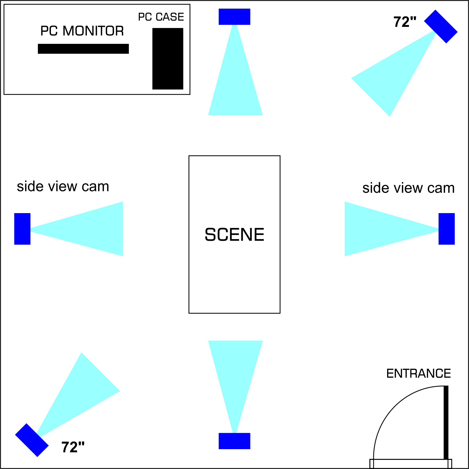

6. Camera Set UP
I've attached the camera set up plan image to the post (Camera_Set_up.jpg), to show u how did I position my cameras in the room I use currently... Is this structure ok? I'll use your advice in the next room I'll find... I have 6 tripods, 4 of which are 50'' and 2 are 72'' high. Is it necessary to make actor fully visible in all 6 cameras all the time? Because to reach that I had to extend the height of 3 cameras by putting these on some small chairs... Some people say do not recommend making all cameras too high, because although it makes the actor visibility better, the capture quality can be lowered... I'll try to find a room which is large enough to be able to capture the actor without extending the tripod height... But anyway...

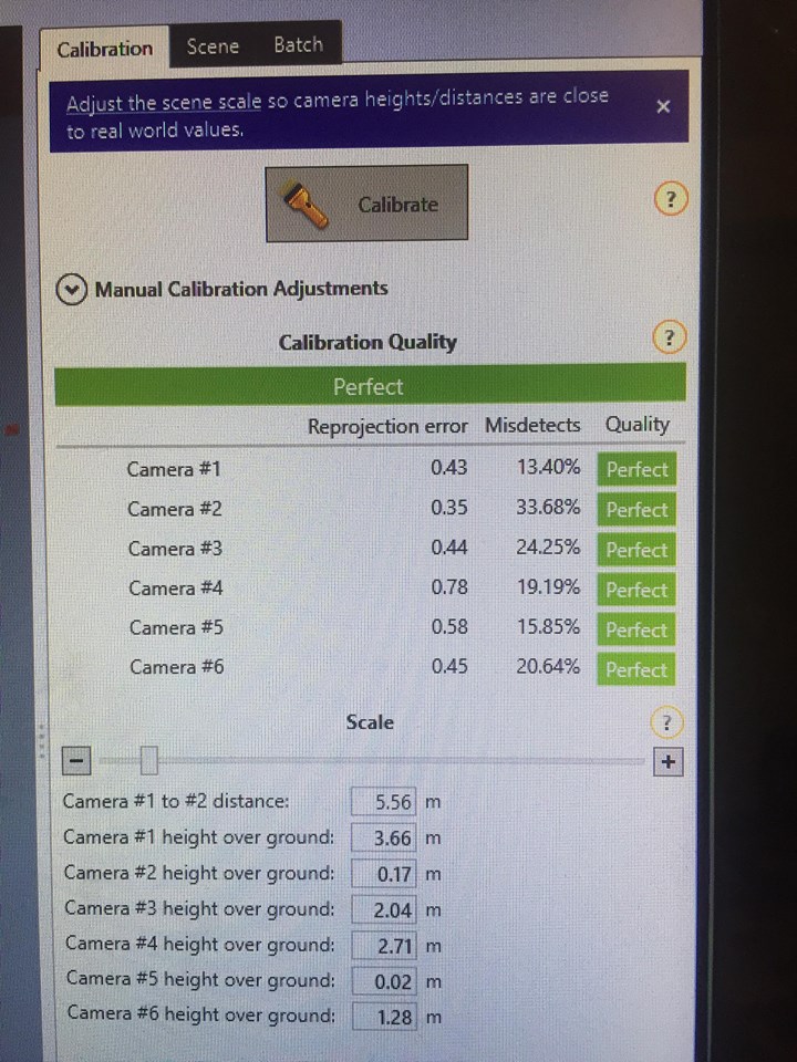

7. Calibration
I've made the Calibration test. 2 images are attached ("calibration_result.jpg" and "calibration_preview.jpg). I've got 'perfect' quality result for all 6 cams. Marked 6 ground points. Though, u can see in the image "calibration_result.jpg" that some of the camera heights are really incorrect (camera #1 & camera #5 with 0.17m and 0.02 heights...). I couldn't change it manually, because when I try to change one of them either by scaling or by typing the desired number in the field, all of the camera heights change proportionally and the result stays messed up anyway... What could be the reason of the incorrect heights captured by the ipi recorder? Is it possible to avoid that initially, or at least correct it manually in ipi studio?
P.S. I also wonder whether the order of the cameras is important or not? I mean which camera will be camera #1, camera #2 and stuff... I know it can be reordered in ipi recorder by dragging the screens... Please let me know if it's so and how...

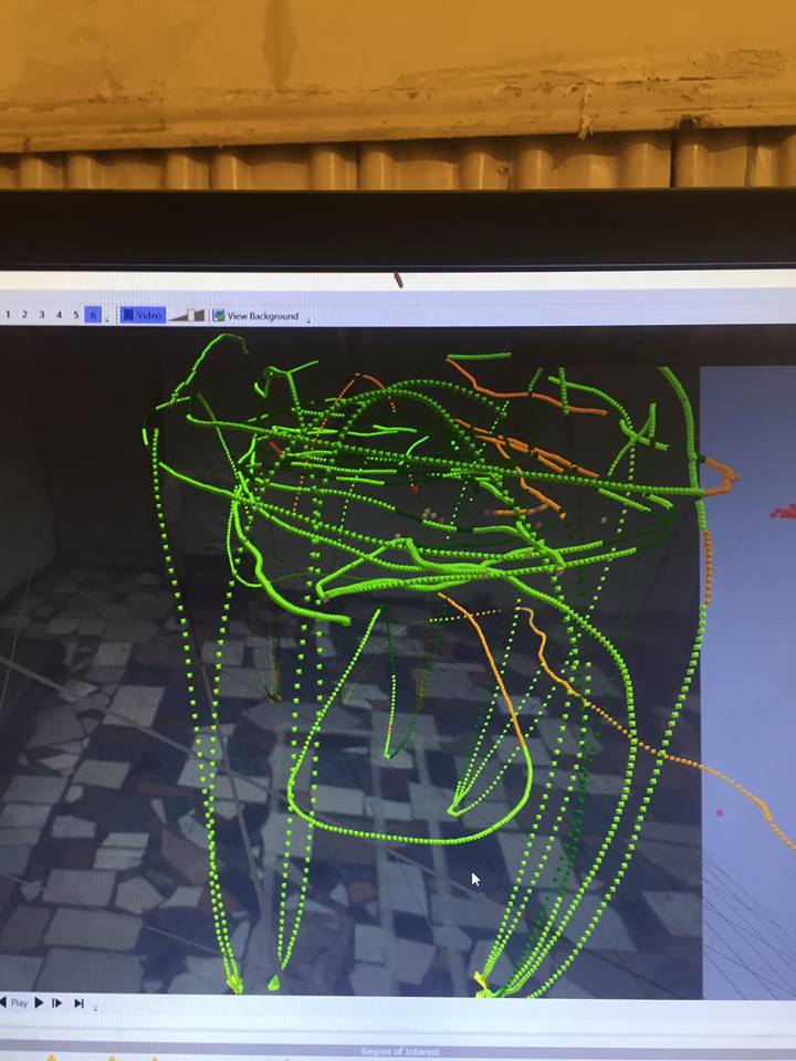

8. Motion Capture Test
I've made my first motion capture test after the calibration. The ground was incorrectly captured... The hands where captured more or less normally, but legs got screwed up right after I pressed refit the actor pose and was just static, while hands where moving... I know that my ground floor texture is terrible and I didn't have correct clothes on me, neither a tight pants and black shoes, instead I was in shorts and white running shoes... But is that the reason of it or there's something else that affects the bottom body to get screwed up?

6) Camera positioning seems to be mostly a personal choice, you can probably get 5 different answers, from 5 different users, depending on their rooms, but I will explain my set up, room is 22 ft (7 m) length x 12 ft (4 m) wide, all cameras are fixed to walls, so never get moved, but tripods are fine also.
I run 6 cams also, 3 - front cams (1- centered @ 1.50 m, other 2-approx. 1 ft forward of the center one @ 7 ft. (2.15 m?), 2 - sideish cams off centered by about 5 ft. to the rear, facing more down on area @ 8 ft. (2.42 m), 1 - rear cam at 7 ft. (2.15 m), had to place this way due to my room width.
You need to maintain at least one cam at 1.00-1.50 m, ( I use 1.50 m), in order for calibration to work accurately once in tracking process, best to be the front cam for this.
Some also use real low cams facing upward, but unless room is completely free of obstacles, this is a hard placement to achieve and also hard to keep lighting out of the lenses.
Make sure cam FOV of lens on all PS Eyes is turned to blue dot before recording anything, alert in top right corner to warn you also :)
7) Cams should run in order of the circle from #1 to #6, so drag the order in the view ports to match that, I don't think this matters per say, but easier to keep things in order in your head when you look at the monitor.
Calibration process is the most critical part of the tracking process, so get that very good, seems you have a lot of misdetects shown, that number should really never have a whole number in front and optimally be very low, like .25% or less, I usually consistently get .15-.09%, BUT iPi says up to 10% should be fine, I have just never got that many and all cams misdetects should be a very similar number, mine are always all the same, if 1 cam is 13%, all the rest will show that, but may not be a very big issue as long as all cams are closer in % number for misdetects.
Your reprojection error amount is fine, this should always be below 1.00 on all cams, lower the better, so .45 is very good.
I also use a different light marker trajectory than iPi shows theirs, I dont use the high trajectory cage method, I just run my light 2-3 ft off the floor around the circular perimeter of my capture volume, once more around touching the floor on front, r-side, rear, l-side, then once more around 2-3 ft. off floor, then touch the center point to finish and my calibrations are always very good.
Yes, when you change the value of the first cam, it will adjust the rest to match, this is proper, no need to play with the manual adjustment tools ever!
I use my front 1.50 m cam as my main #1 cam, so set all rest correctly to that, and with new v4 calibration, all cams are exactly perfect to the floor in Studio now for tracking.

8) For capturing, since you are using 2D video, clothing colors are very important, as well as a tighter fit of clothing, iPi suggest a different color for each part, or set of body parts, feet one color, hands another color and so on, but I don't use that method either, so maybe not my place to deviate from their suggestion.
You must have detected the Actor colors before refit, but since didn't have the right clothing at all, that process would never work properly anyway, until you do.
The floor is a major issue, Yes, if have to use that room for a while yet, get a piece of solid color (tan) linoleum, or a lighter colored throw rug large enough to cover the capture volume, something lighter, even a heavy white canvas painter's tarp will work, just affix it tightly stretched on the floor, so feet don't pull it and bunch it.

Generally, you should avoid excess USB cables whenever possible. Directly connecting cameras to PC is the best way though not always possible. To place a camera at longer distance use active USB extension cables. Avoid passive USB cables at all costs, but if you use them then max 1x3m per camera. Active cable differ from passive in that they have a box somewhere on the cable - usually at female end.
PS Eye camera is USB 2.0 device so use USB 2.0 cables even when connecting to USB 3.0 port. USB 3.0 cables have tighter limits on allowed length than USB 2.0.
Graphic card is not used extensively for recording. You can record successfully with integrated graphics.
Whether 50 fps is OK depends on motions you're going to capture, but usually it is. For regular motions even 30 fps is OK. Higher fps provides better accuracy of tracking for fast motions like running, fighting etc.
Your lighting does not look too bad actually, although the quality of attached photos does not allow to evaluate it fully. If video does not look grainy then should be more or less OK.
Please check whether all cameras are set to wide FOV (camera lens rotated to the blue dot). If not this might be the source of improper calibration. You can share your calibration video via file sharing service so I could look further.
There's not much purpose in doing mocap test until you get digestable calibration results. However, I can make a few points here as well. Yes, you need to wear long pants while acting because Mocap Studio's actor model does not support shorts. Also, do not forget to adjust both actor dimensions and appearance to match actual actor. And align actor model with all camera images before hitting Refit Pose for the first time. Legs might be not tracking because the ground plane is incorrect and ground collisions were turned on for tracking.

When aiming your cameras, there is a grid tool that is very helpful, if you have a clearly marked center point of capture volume, or you can place an object in the center, like a soda can, or something, it will help in running the grid lines straighter through the area and the cross-hairs will most likely end up being right at performers hip level.
You should try to keep the performer visible in all cameras, but as long as 3-4 cams maintain full visibility, even if in a couple the hands may go out of frame on full extension, it will still maintain tracking very well, I used to have my 2 side cams centered to view only the upper back/chest, hips and feet when standing centered and it worked fine, I just moved those toward the rear about 5 ft. now to get more floor coverage.
I hope the explanations were understandable in prior posts, it seems like a lot to comprehend, but it really isn't once you go through the set up and get it all functioning properly, then maintain that same routine anytime you record, even if you can't leave your cameras set up, but it helps if you can.
Just remember, after you do a calibration, no camera can be moved, or even bumped, or you will need to re-calibrate them all and best to perform a before and after full session calibration recording, (meaning when you are done recording for that day), just as a back up against inadvertent camera movement.
Taping the camera cords to the tripod may help, some used PS Eyes aren't really tight on the base and just the weight of the cords hanging can make them drift up just enough to screw up calibration.
