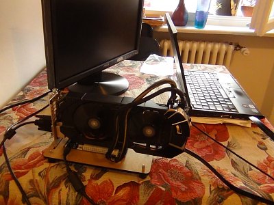

- The start hw is a laptop (in the future a proper desktop can be purchased, not 100% sure tough), a Lenovo X220 with 8GB RAM, i5-2520m 2.5 Ghz dual core with HT CPU, Intel HD3000 iGPU, + an external GPU Sapphire Radeon HD7950Boost, attached the setup image

- The internal GPU will be not enough I think both for recording and data analysis, so the external need to be used. Anyone does try the eGPU setup?

GPU usage during recording is fairly low, so integrated GPUs are usually sufficient. However, for the tracking process in Mocap Studio, the GPU performance is essential. HD 7950 seems adequate, if it performs as well as when plugged in a regular desktop.

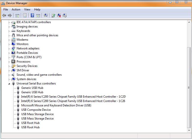

Not an hardware expert, looking at device manager I did find the picture situation.
Looking at the two devices connected on the two available USB ports their properties show: Port_#0001.Hub_#0004 and Port_#0002.Hub_#0004
This mean they did use the same Hub, limiting the connected cameras FPS?

Reading http://docs.ipisoft.com/Cameras_and_Accessories#USB_controllers I got I did have only 2xUSB 2.0 controllers, one of them is used, so I can use max 2 cam.

PostPosted: Thu May 05, 2016 9:53 am
Yes, an USB controller in the form of ExpressCard will allow you to connect more cameras. 2 ports of laptop + 2 ports of USB ExpressCard = 4 PS Eye cameras (2 per controller) or 2 Kinect v1 depth sensors (one per controller).
