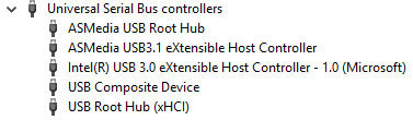

This is what I have:
1 x USB 3.1 Type-C
2 x USB 3.0
1 x USB 2.0
The GPU is a GeForce GTX 1060. Will I be able to get 6 PS Eyes running @ 60FPS on this? I am guessing that I would need 2 USB 3.0 hubs, is that correct?

Yes you are probably able to connect 6 PS Eyes to this PC. I'd separated them in pairs among USB 3.1, 3.0 and 2.0 ports. USB 2.0 hubs should be sufficient as PS Eye is a USB 2.0 device.

Before buying hubs check that PS Eye camera works with every USB port available. Especially USB 3.1 port which is of ASMedia controller as there may be compatibility issues.
