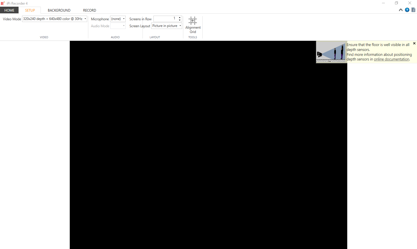

so i recently got all the stuff i need for mocap however apon opening the software i find this im using a xbox 360 kinect and windows 10, if anyone knows how to fix this it would be of great help!
File comment: the black screen that i see

Looks to me as an USB or driver issue.
  • Please test various USB ports of your PC for connecting the Kinect sensor.
  • Also try to set a depth-only video mode
  • Ensure you don't have any other drivers for Kinect installed besides Kinect SDK. If you're not sure, you can uninstall every item from apps containing "Kinect" or "PrimeSense" in it. And then install Kinect SDK 1.8.
