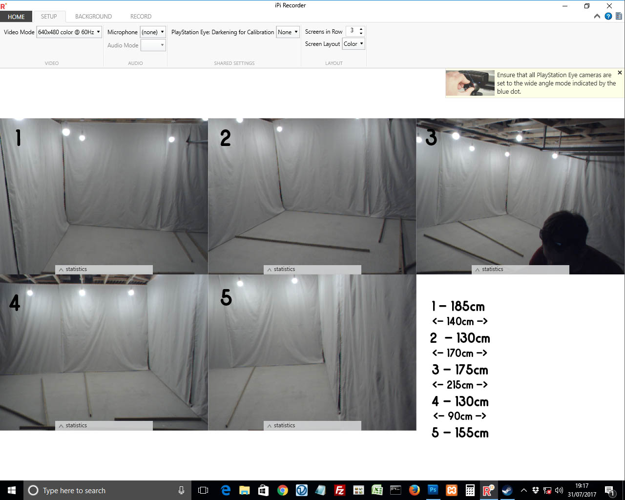

This is my first post but I have been looking at and setting up my workspace for quite some time. I now have everything setup but I wanted to ask a couple of questions regarding camera heights and lighting.
I have rigged up 5 cameras covering 2 sides of my garage and with a clear floor space of 4 x 4m. I have white sheets up on the opposite sides and the floor has been painted grey, when I remove the background all I get is green - but at the moment once I come into view I have light grey shadows casting in 3-4 directsions (I have 6 x 90 lumine LED bulbs on the ceiling in 2 rows of 3 covering a 2 x 4 m area of the floor.
My questions are - with 5 cameras should the heighest cameras be the furthest away? can I lower the 2 ends to ensure more floor space is covered by all 5 cameras as my understanding is I can only record within the space covered by all 5 cameras? The strips of wood were from me trying to see what floor I can use with my current heights which are included on the screenshot.
My aim is to record motions for a field hockey sports action computer game so I want the movements and the hand positions to be as realistic and as accurate as possible, I have 2 imotion records should I attach both of them too one stick or would one be sufficient and would it be better where one hand is or in the middle of the stick? Perhaps if anyone has done anything with a sord like prop they could share their experience.
With regards to the lighting is there anything anyone could suggest that i could do to diffuse the light so I can get rid of the shadows completely? I don't currently have any shades (as you can see in the picture could I use something similar to photographers lamps or would I be better o try up lighting, say perhaps some decking lights to cast the shadows up to the ceiling?
Any help suggestions would be greatly appreciated :) really hoping I can make this work really well :)
Thanks,
Simon
File comment: 5 cameras with their heights the measurement between each one is the distance (camera 3 is right in the corner, camera 1 & 5 are on the far corners ish)

Nice start to the set up, but it looks like you have a few things off, these are just some of my personal suggestions below, so I hope you understand what I am trying to explain.
1) All cameras should all point toward a central point at chest height off the floor, not meaning the camera height all at chest height, just point them at the chest area of the performer, best to have a bit shorter performer to measure this, about 5 to 5'2" works well, or whatever that translates into for meters and have a clear highly visible center mark on the floor you can see in all cameras and this mark should be very close to the same position in each of the recorder view ports to each other.
If you aren't using a rear camera pointing forward, the set up in the image won't really work that well for 360 body rotation tracking, your capture volume only being 4m x 4 m between the cloth, you will only get max of 3 m x 3 m movement area, but you should use a more semi circle set up, with the 2 rear side cams about 1 to 1.2 m off the back wall and higher up pointing downward at about 2.3-2.4m and just slightly further away from the center mark, (this may be hard since you will have the cloth possibly interfering with their view, but you could angle the tops of the side cloth back to give more room if possible, because you want those cameras to always fully see at least the full head of the performer at all times), these 2 cams can be placed in the 2 rear corners, pointing slightly forward looking, but better if just slightly off the rear wall by 1-1.2 m, for better video depth and hip tracking, and so you can turn with arms fully extended out and clear the back wall easily and have less chance of loosing tracking on rotations, especially if the arms are close to the body when doing a motion.
The other 3 cameras should be one directly in front of the performer at a height of 1.20 m and the other 2 at a 45 degree angle in the front corners at heights of between 1.50 m and 1.70 m, but better if one side is a bit higher than the other, like R=1.50 m L=1.70 m, this little offsets helps for a slightly different view when tracking.
You should get one more camera if possible to use as the very high center front cam pointing down on the performer also, and just a bit closer to the center mark, do not worry of it doesn't view the full arm extension of an action, the other 5 cameras will handle that, this cam works for better foot to floor contact.
2) I personally don't think you have enough light yet, based on if that's all you will have during recording from that image.
Although, PS Eyes don't work well with intense light, so you need to find the sweet spot for them, so not to wash out the recording in the studio for tracking.
3) Those type lights aren't best as they throw weird shadowing and iPi tracking doesn't like shadows, so if you have to use those lights, make a ring, or rectangle with them around the outside area, between your central floor mark, (which you should have and use a visible marking), and your drop clothes, not really necessary to have direct overhead lights over the center or performers head.
4) Try not to have any lights where the camera will look directly at them, it will cause a washing of the colors and a white film look over the recording, PS Eyes are very touchy to this, but you can adjust the camera settings and reduce the exposure, but you have to know this before you record, or do several tests to find out, because you don't want to have to always play with camera settings before you record, the environment once configured should always try to remain the same, with the same equally ambient lighting.
5) All lighting should overlap one another, or you will cause dead space shadows between them and that isn't optimal.
6) You don't need to attach a Move controller to any props, the tracking doesn't really track props, but if the prop is too wide to block the tracking, it will cause issues, best to use the thinnest props you can, what you want is the hand locations on the props from the moves and the wrist rotations needed, not to track a prop, because iPi doesn't have extra bones to use for that purpose... yet, so you won't get any data from the Move to accurately use.
Of course all set up configuration is up to you in the end, but I hope some of this helps you understand and the reasons for it, but really too much to go through in just this one thread, but you can use the Search function in the forum to hep find more references and post.
Good luck and please post more once you get set up and tracking to your liking, it will be a trial and error mess for a bit since you are just starting with PS Eyes, but it doesn't take very long to get it working well. I will say that the calibration phase is very important, so get that as good as you can consistently.

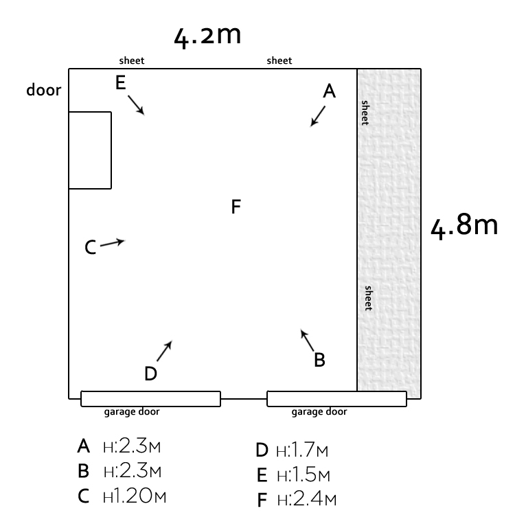

I have the garage clear again (ish) I have tried to map out what you suggested in photoshop before I implement it just to make sure I understood what you meant. I have a little more space than thought. If I really need it I can go into the patterned area by removing our bikes etc but it just means I have to pack up stuff every time I record with this setup I should only have to move D so we can open the garage door.
With your description of the rear cameras and the 6th "on top" at the centre point it felt like the 3 of them would be almost on top of each other but I have attached the PSD in case you have photoshop and then you can move them where you meant them to be if I have done it wrong? I really appreciate your input I will try to action this later this afternoon if I get a chance.

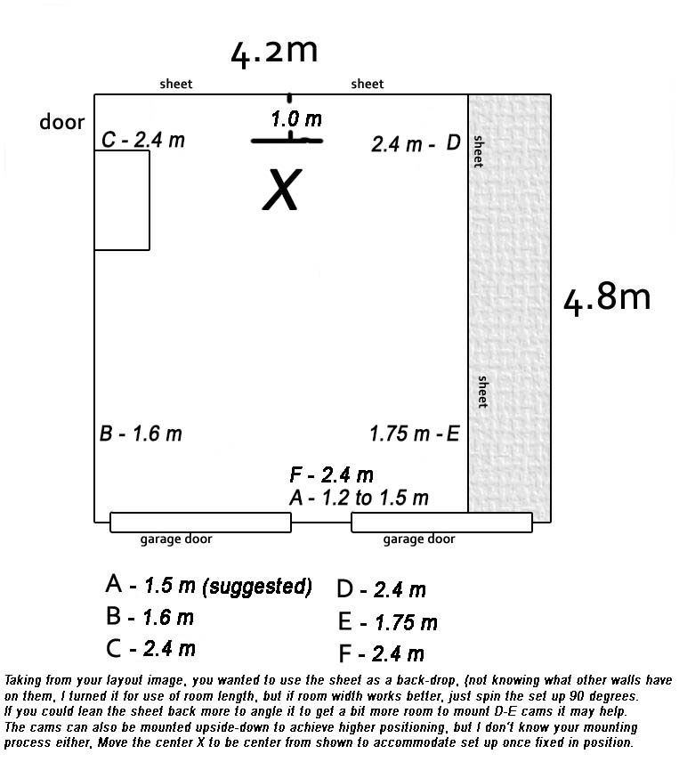

What you show isn't quite what I meant, but a very tight area for PS Eyes use for much performance area, I attached an image to better show my perception, but you can spin it in any direction to better accommodate you, it would be possible to also use a catty-corner positioning, just spin the image 45 degrees, but the heights can remain similar, that may even work out better, I just didn't lay the image out that way, but I think you can follow what I am saying to maximize the floor capture volume..
(Note: You can turn cams upside-down when mounting to get higher, then switch those cams using the upside-down setting in cam parameters)
I don't know your mounting process either, but if all will be fixed in position and left alone, mount them securely and secure the hanging wires to not tug on the cams.
Basically, you want to get as much ground area as you can visible to each cam, because the feet area will be the limiting factor for most actions, the arms extended in all cams won't be as critical, (referring to the 2 rear cams), but in the area shown, you can never get a fully centered performance area, you will need to be against one wall, or another, or in a corner when performing.
It isn't shown where the computer will be stationed, but it looks like only limited area it can be anyway to allow for full performer view in all cams, if it's only a laptop for recording purposes, that would help, but not sure 6 cams can be used on most newer laptops easily, so 2 laptops just to record defeats the purpose of even using PS Eyes.
I hope I made it a bit more understandable :)
Good Luck!
