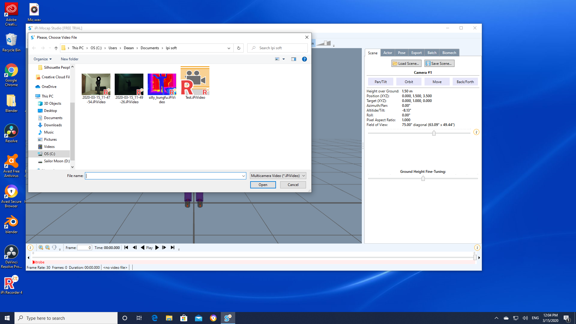

My files which are MultiCamera Video (iPivideo) are not uploading into Mocap Studio. When I click on 'new file' or 'open', I am prompted to browse. When I go into the folder which have my pre-recoreded videos that I used with iPi Recorder, the files do not show. When I click the arrow button so as to manually choose the file, iPiVideo files is not an option. I read about an iPiVideo extension file but am confused because the Wiki does not state where to find that file; in fact, the Wiki doesn't state anything about errors which is a drag. I am in the free trial version of the software which is good. Don't want to pay for anything that is not working. Any assistance is appreciated.

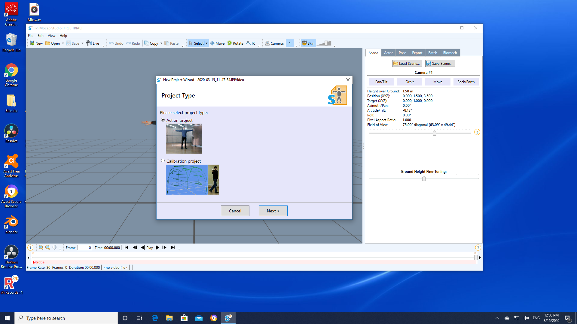

So when I open the MoCap Studio, I click 'New project'. I then click on my video which is something_something.iPiVideo. The software allows me to choose 'Action' or 'Calibration'. When I choose 'Action', my video does not show in the folder. I then exit out of 'Action' and choose 'Calibration'.
See, so I am not able to import my videos as 'action'. Does the above make sense?

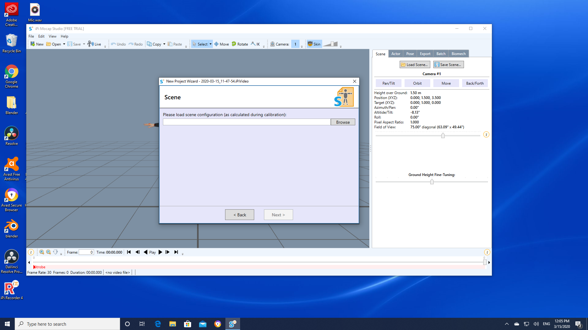

The second step for action projects asks you to select the source of scene configuration, not a video (which has been already selected before the wizard appeared). That is, where to load camera positions you've got after running calibration from. This may be a calibration project, or another action project (each project stores scene configuration) or a separate scene file (which can be saved at Scene tab).

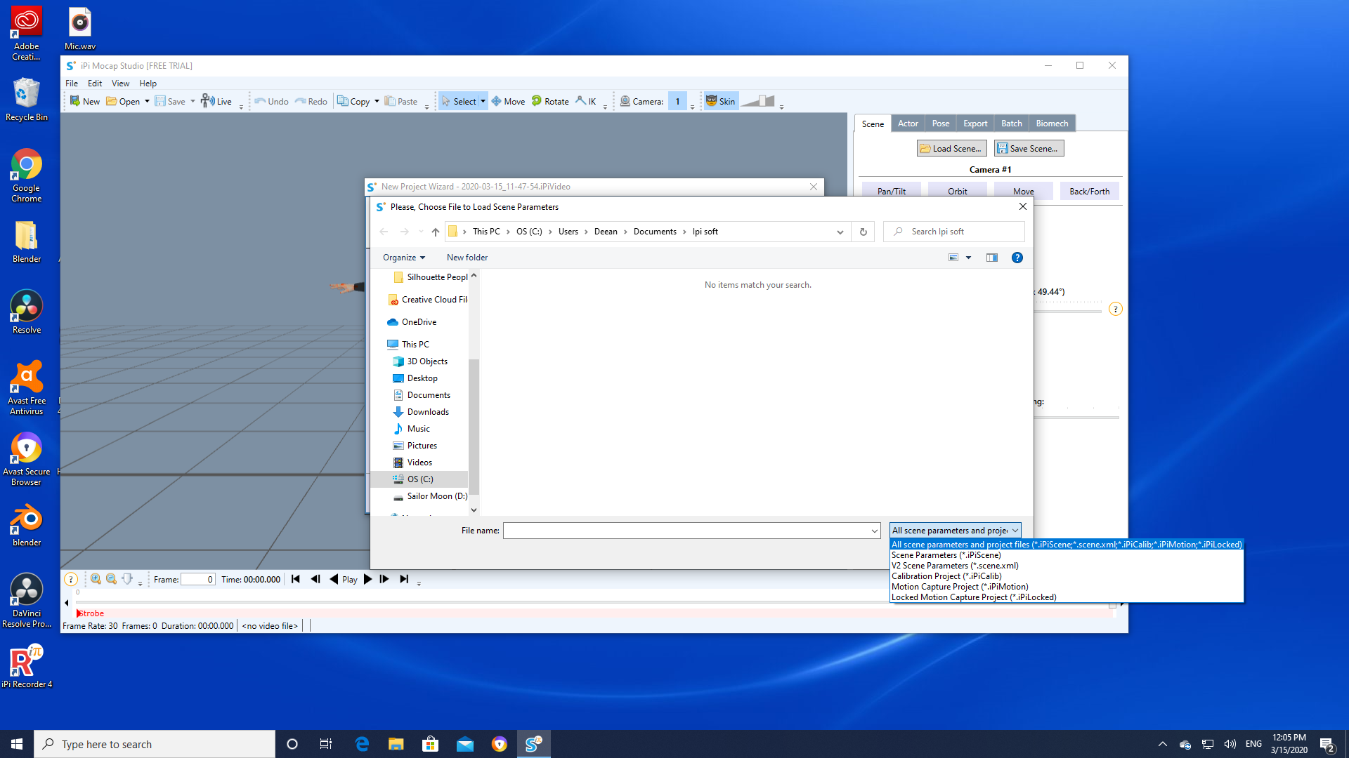

I don't know what you mean by this. However, I took some screenshots.

As you can see with the three attachments plus this one, I don't have an option to add my .iPiVideo.
