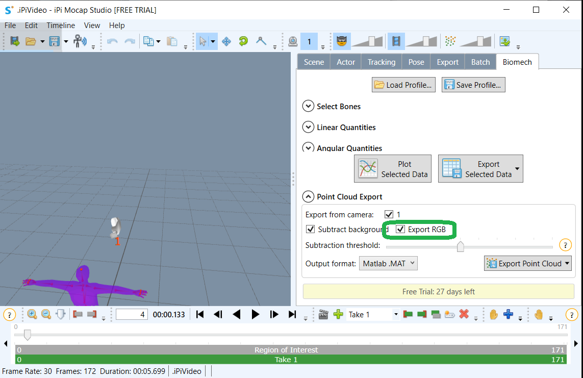

Hi! So my question is how to get RGB images of frames (from all cameras). It would be better to get it in the form of video or separate images of each frame.
I found a way that it is possible to download the RGB data along with the point cloud from "Biomech".
But it is quite difficult to get the result as a video from this export file (matlab).
Maybe I missed something and there is an easier way, tell me please. Thanks in advance!

iPi Recorder has built-in ability to export RGB stream to an AVI file. Check the docs
http://docs.ipisoft.com/iPi_Recorder_User%27s_Guide#Editing_and_Export
Keep in mind that export function requires a license for iPi Mocap Studio installed on the same PC. And the number of cameras supported is limited according to the license edition.

Thank for answer, it helped!
