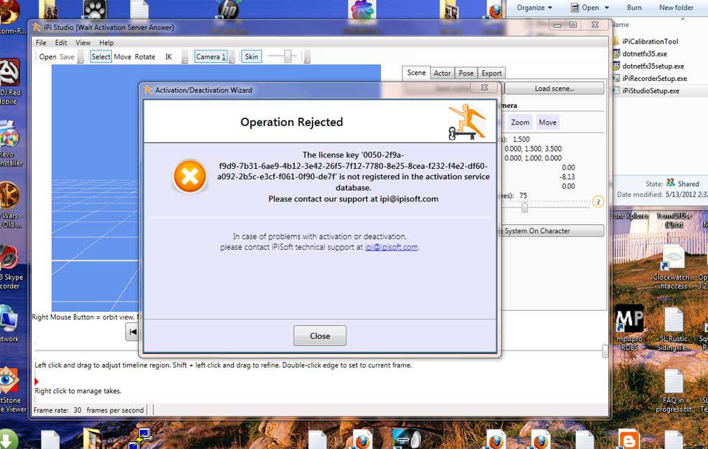

Update:
After uninstalling and reinstall, and doing a massive sweep for any left over iPi software on my main computer. Finally get iPi Studio to run, only to get Operation Rejected on it validating the Trial Software.
Attaching a screen shot.
Very frustrated
File comment: Screen error on loading

PostPosted: Sun May 20, 2012 3:28 am
Posts: 795
What is seen on the screenshot is an invalid license key generated by pirate keygen. You should not have used that key in the first place. Apparently we cannot be responsible for that. Trial version does not even require any keys.
You can always use another computer to run the trial. Alternatively, you can wait for v.2.0 (to be released soon). We will globally reset trial period for v.2.0.

Yeah, found out a friend about 7 months ago showed me iPi.
Didn't know he was showing me a hack program. Very pissed off.
So when I decided to look at iPi myself, that hack was still on my system and effecting the trial software.
