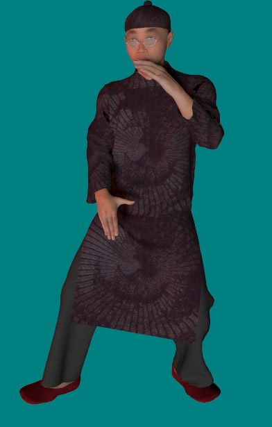

I have been struggling with Poser 2012, but still problems, I think it is down to my lack of knowledge and not enough information out there. But still I solider on,
It would be great to learn lightwave, as I have marvelous designer 2 for making clothes, and its export is .MDD.
I am a bit frustrated as a part of my life I am a Tai Chi player. I would like to turn myself into an avatar.
Still a way to go :)
Any help along the way would be most appreciated.
