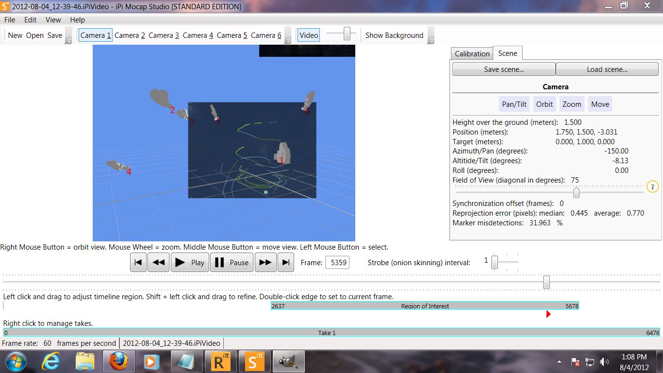

I repositioned my cameras and got better results but some of the cameras after auto calibrate are still in weird spots. I did one calibrate that camera 1,2,3 were perfect but camera 4 was off and that I think throws off camera 5 and 6.
I can see my markers in most cameras at most times, but one camera is sitting on an angle and not tilted a bit, does that matter? Also in previous tries sun shone into a window and stole my markers :)
Before calibrating I reset the cameras to reverse clockwise full circle.
I attached an image of what the calibrate looks like now.
Do you see anything else I could be doing wrong?
Thanks!

Just a quick observation--the cameras seem a bit high up. It's good to have one or two cameras up high (8 to 9 ft) but the rest should be between 4 -6 ft up.
I used to shoot with PS3 Eye cameras in a space about that size but I used a half circle config because with a full circle the capture space got a bit too cramped for me. When I use PS3 Eye again it will be in our backyard where I have a lot more space. (I currently use twin Kinect in the living room for most of our motion capture sessions.)

Most of the cameras are 4-6 feet high. What that screenshot is, is the miscalculated results from running auto alignment on the cameras.
I just got a calibration with 4 cameras calibrated right, I am currently trying to manually calibrate the the 5 and 6 camera.
Manual calibration is proving to be difficult. Does it matter if the 5th and 6th camera are a touch out?
Thanks!
