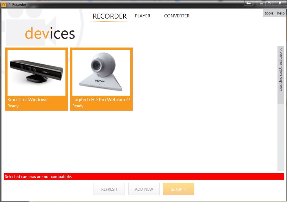

Greeting all,
I am trying to get started in recorder and it says selected cameras are not compatible. What now? I am trying to use Kinect
PostPosted: Wed May 08, 2013 4:46 pm
By default all available cameras are selected. But software cannot record from depth sensors (like Kinect) and color cameras simultaneously. You should choose one option.
Just click on web camera to deselect it. Then you can do recording with Kinect.
