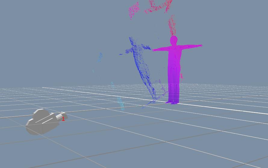

just like this picture,why

The ground plane is not detected properly. This is usually caused by a too small amount of the floor seen by camera. Either the camera is looking too high, or the capture area is too small (props on the sides).
For the stable ground detection, at least 1/4 of the picture area should be occupied by the floor.

thanks ,I got it.floor is too small and is not detected.
